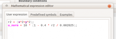

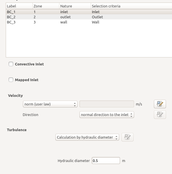

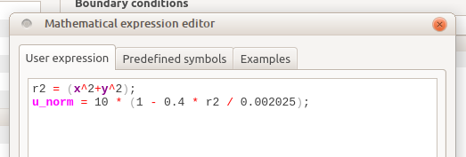

For the first step, because I'm not able to write programs in C/C++, I did a different method to add 'special' boundary condition at inlet.
I used a "Norm (User law)" for inlet BC, producing the same law written in tutorial pdf; attached two snapshots.
This 'escamotage' works perfectly.
