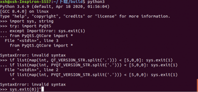

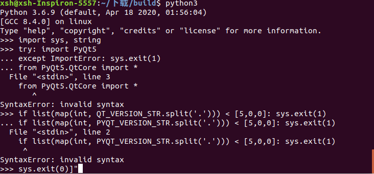

i try in a terminal:
import sys, string
try: import PyQt5
except ImportError: sys.exit(1)
from PyQt5.QtCore import *
if list(map(int, QT_VERSION_STR.split('.'))) < [5,0,0]: sys.exit(1)
if list(map(int, PYQT_VERSION_STR.split('.'))) < [5,0,0]: sys.exit(1)
sys.exit(0)]"
result is following:
GUI ISSUE

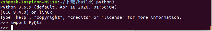

Were you careful with the indentaton in the terminal ?
In any case, when testing from a terminal/Python console, the following should be enough:
If this fails, it means you need to install additional python3/Qt5 packages (Ubuntu tends to change the package names once in a while, so I do not remember the exact names, though it would be useful to keep track of them on the GitHub Wiki, since this is a recurring problem... I'll try to do this today.
import PyQt5Best regards,

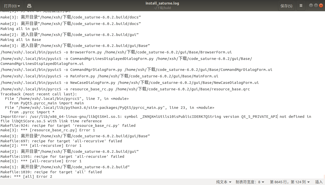

but i have another trouble now.it seems that there are some problems with pyrcc5
- Posts: 4282
Re: GUI ISSUE
I'm not sure about this one, but is seems the pyrcc version installed with pip is not compatible with your system libraries.
Why can't you simply use the Ubuntu PyQt5 packages ? At least you would have consistent libraries and updates. Otherwise, you might have a mix of pip-installed and Ubuntu pyrcc5 (depending on the sourced environment variables).
