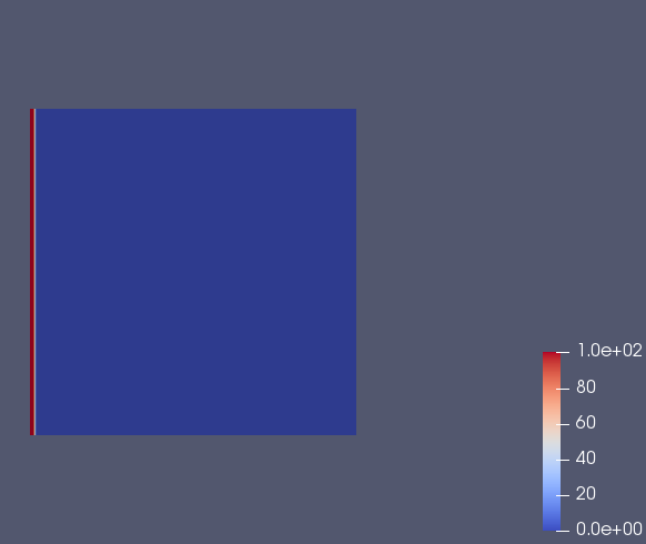

The problem is that why it uses treco(ifac) instead of treco(iel)?
The ifac is just a number from 1 to the number of selected faces and it does not specify the cell which the calculated variable belongs to.
But iel is the id of cell that specifies the exact cell which the calculated variable belongs to.
So in post processing, the computed parameters are on wrong cells.
Is there any reason or the written code is incorrect?
