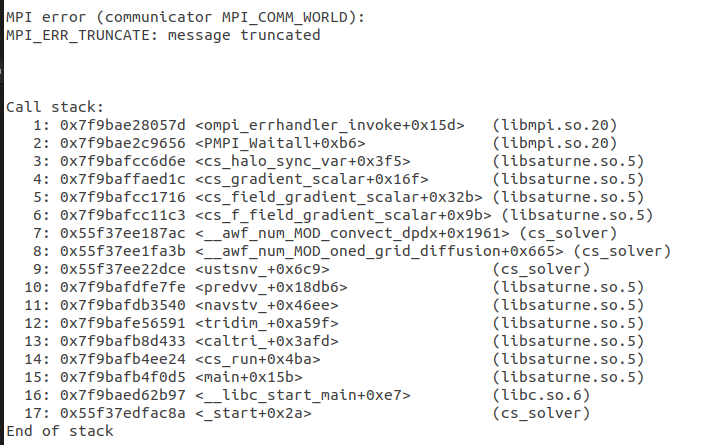

Hi all,
I came across a problem when I tried to call the 'call field_gradient_vector(ivarfl(iu), 1, imrgra, inc, gradv)' or the pressure gradient in a subroutine that I build up in the cs_user_module.f90. For some reason it works fine when I use 1 processor. When I switch to more, I get " MPI error (communicator MPI_COMM_WORLD):
MPI_ERR_TRUNCATE: message truncated"
Any ideas how I can fix the way the gradient variable are communicate with the other processors to fix it?

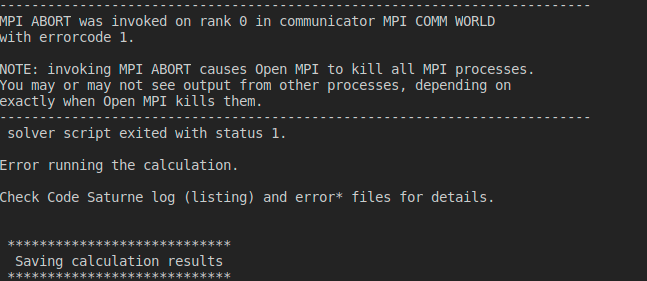

The idea is to compute the tangential pressure and the velocity gradient of the boundary cell and then pass that info to a define module. The define module will include both subroutines for the gradients, the subroutine that calls for further calculations and any additional functions that are needed.
Please find attached the error message ..

Re: Velocity_gradient_calculation
Dear Yvan,
I think the problem arises because I try to select a boundary face,<call getfbr>, and based on that selection call the gradient function for the near boundary face cell. For 1 processor the code runs ok but when I switch to 2< it fails since the second processor does not see that information on the same near wall boundary face. I tried to use the synsca function before the gradient call in my module subroutine and print the rank in a file but aparently the second processor which the boundary face is not included it does not show/sync. Any suggestions how can I get the right synchronize gradient information on each processor for the corresponding face selection?
Note that I also use periodicity and halo cells are involved.
Costas
Costas
- Posts: 4300
I do not understand how you use the gradient function for specific cells, since the function applies to all cells.
In any case in parallel it is a collective function so all processes must make the same call (with their local data of course).
