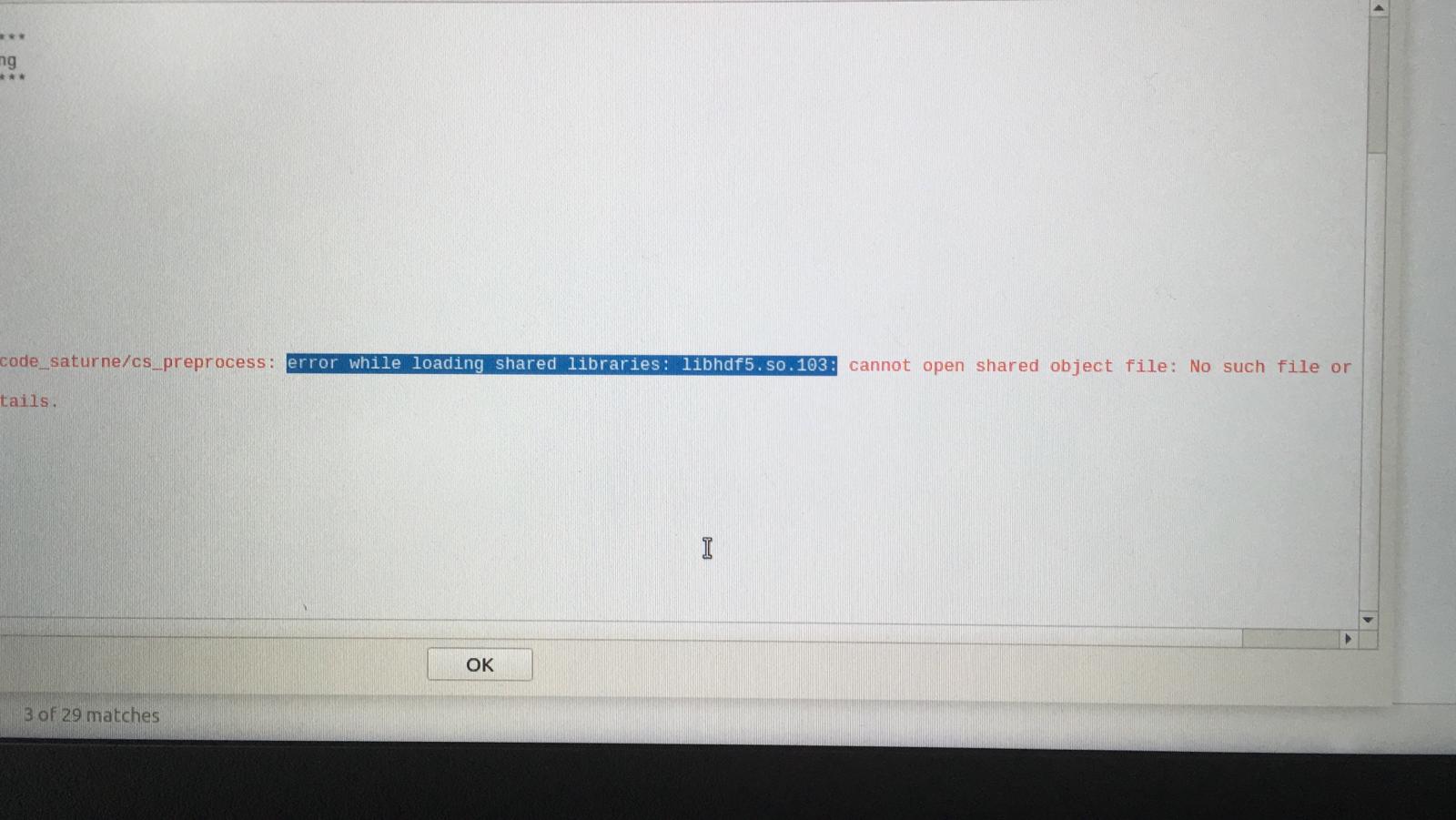

Basically when I tried to configure with the medcoupling it gave an error that it failed for the target 'fvm_medcoupling_la-fvm_to_medcoupling.lo'.
I tried without the med coupling, the installation goes well though when I try to run a case I get an error saying that:
'error while loading shared libraries: libhdf5.so.103: cannot open shared object file
Please find attached the screenshots
Thanks,

Posts: 4290
Re: Installation_configuration_errors
The MEDCoupling issue may be due to a change in the MEDCoupling API. You may try to see if you are more sucessful with Code_Saturne 5.0.10, but you may need to switch to Code_Saturne 6.0 beta (or maybe 5.3) for recent MEDCoupling versions.
Or if you do not need MEDCoupling, just add --without-medcoupling to the configure options.
For the libhdf5 load issue, a more recent version (5.0.10 or 6.0 beta) may also help, otherwise you need to either add the path to HDF5 in LD_LIBRARY_PATH, add LDFLAGS="-Wl,-rpath -Wl,/<path_to_salome_directory_containing_libhdf5.so>, or run from a "salome context" or "salome shell".
V6.0 tries to make this easier, I am not sure about v5.0.10 (we added improvements but maybe not enough).

Appreciate a lot your quick response. I was reading about the LD path that you suggested in the installation guide though I was a bit confused. Could you be a bit more specific on how to add the flag with those arguments?
I run the following to configure:
sudo ./../src/code_saturne-5.0.10/configure --prefix=/opt/Code_Saturne/v5.0.10/arch/ PYTHON=/usr/bin/python --with-metis=/opt/salome/SALOME-9.3.0-UB18.04-SRC/BINARIES-UB18.04/metis --with-blas=/usr --with-scotch=/opt/salome/SALOME-9.3.0-UB18.04-SRC/BINARIES-UB18.04/scotch --with-cgns=/opt/salome/SALOME-9.3.0-UB18.04-SRC/BINARIES-UB18.04/cgns --with-mpi=/usr/share/mpi-default-dev --with-salome-gui=/opt/salome/SALOME-9.3.0-UB18.04-SRC --with-salome-kernel=/opt/salome/SALOME-9.3.0-UB18.04-SRC --with-med=salome --with-medcoupling=/opt/salome/SALOME-9.3.0-UB18.04-SRC/BINARIES-UB18.04/MEDCOUPLING --with-hdf5=salome
Costas
Posts: 4290
I am not sure of the path for the libraries in the SALOME-9.3.0-UB18.04 build of Salome. The --with-salome option allows finding this using an environment variable. If you search for the libhdf5.so file in the SALOME structure, you will have its directory name.
Given that directory name <hdf5_libdir>, you can add "LDFLAGS=-Wl,-rpath -Wl,<hdf5_libdir>" to the configure line. You can also simply use "export LD_LIBRARY_PATH=<hdf5_libdir>:$LD_LIBRARY_PATH" before running Code_Saturne if you do not want to reinstall or simply check you found the correct pas first.

Hi,
Thanks a lot for the support it worked!!
