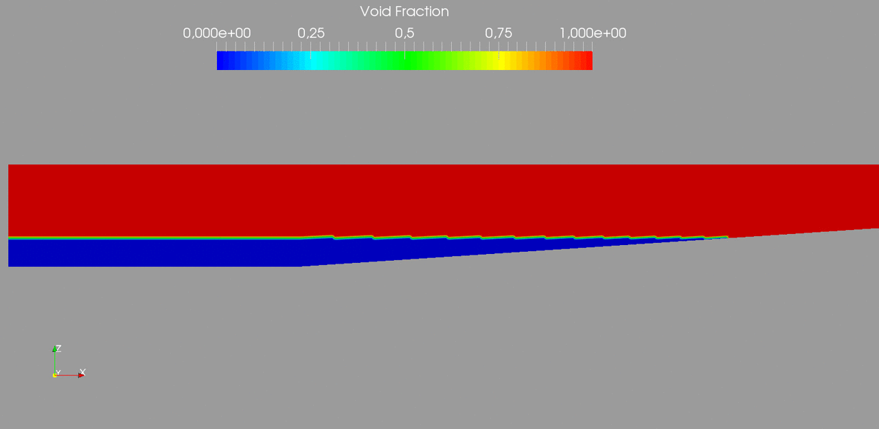

VOF and ALE can be used simultaneously. I did some test with a wave generator.
Be careful with the version that you are using becouse were a bug fixed in the ALE Bc (commit 4b879fa).
Luciano
