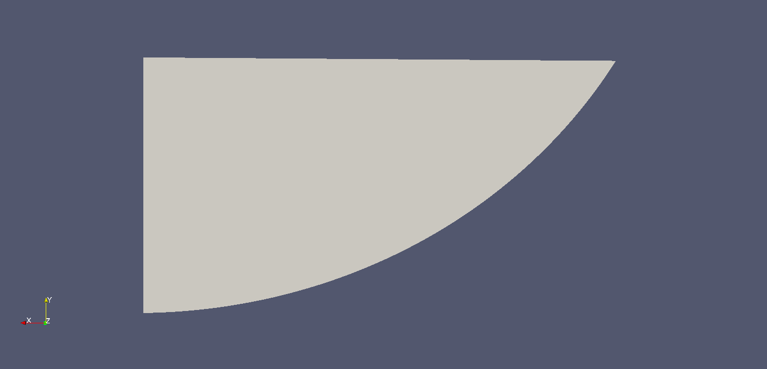

I am trying to impose a volumetric heat source thoughout the domain(not on boundary cells- they have different BCs) in an non regular geometry. I am trying to use following
Code: Select all
do iel=1,ncel
crvexp(iel) = volume(iel)*pwatt/voltf;
enddo
for imposing the heat source term. Do these 'ncel' also select cells on the boundaries or only the cells within the domain(and not boundary cells) are selected ??
As my domain has an arc of a circle instead of other two walls in a regular rectangular geometry. And geometrically it is a bit difficult to define them for cell selection.
Thanks in advance.

Posts: 4080
Re: Several uniform heat source
If you look on all cells those adjacent to the boundary will be selected also.
Note that selection criteria can also include cylinders ou spheres, though using groups is always better when available. (see documentation) but if cells adjacent to the boundary have a special role In your case you can still cancel the contribution on them. If you look on boundary faces, ifabor(iface) gives you the I'd of the adjacent cell.
Hope I understood your question correctly (a diagram would help otherwise if this is a complex case).

Hello Yvan,
Thank you for your reply. Currently I am using following code which adds heat source in each cell and then removes from the boundary cells. But I am not entirely sure if this the correct way of writing it. Boundary faces have colors 1to5.
Code: Select all
do iel=1,ncel
enddo
allocate (lstfac(nfac))
call getfac('1 or 2 or 3 or 4 or 5',nlfac,lstfac)
 do iel = 1, nlfac
    ifac = lstfac(iel);
    iel2 = ifabor(ifac);
      crvexp(iel2) = 0.0d0;
 enddo
deallocate(lstfac)
