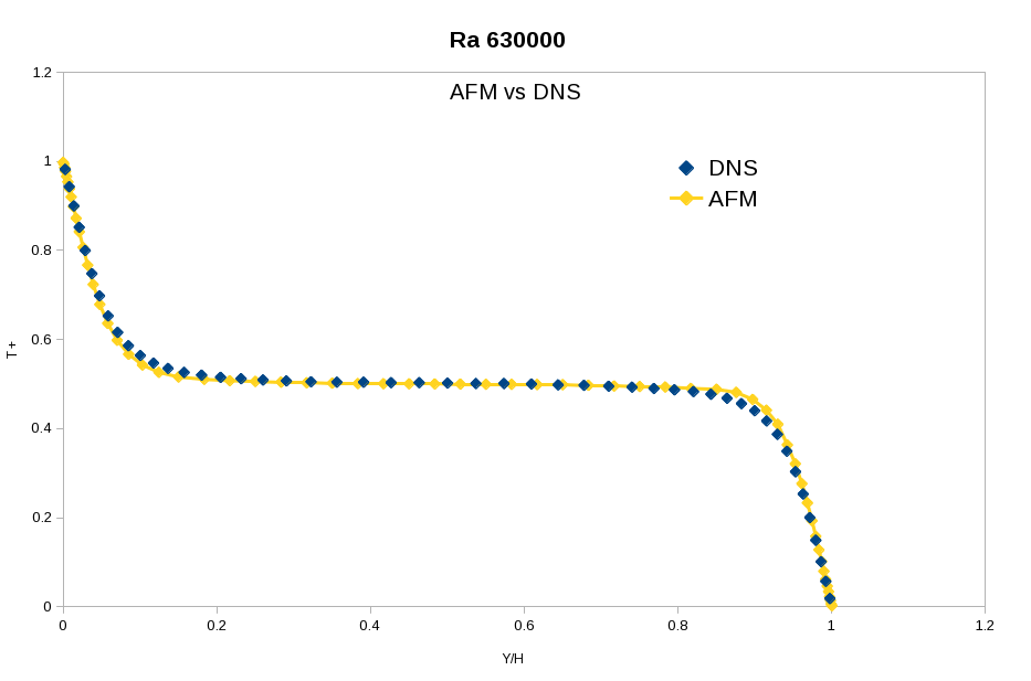

I am running Rayleigh Benard natural convection case with Rayleigh number to be 630000 and Pr as 0.71. I am using AFM as turbulent heat flux model. For boussinesq implementation, I am adding boussiesq(rho*beta*(T-t_ref)*g) source term in momentum equation.
I am facing an unusual problem regarding the turbulent heat flux magnitude. The turbulent heat fluxes for this case are incredibly low value(1e-38 to 1e-36). Whereas the temperature profiles are predicted well when compared to DNS results.
Also the turbulent kinetic energy (i.e. rij values) is also incredibly low.
Code_saturne v 5.1.3.
Turbulence model : RSM-EB
turbulent heat flux model : AFM
The attachment afm_dns.png is no longer available
Kindly suggest few changes.

Thank you for your feedback on the AFM model. Your temperature profile looks good probably because the GGDH part of the AFM works well whereas the additional terms ( bouyancy, velocity gradient,...) might be bugged.
Can you post your test case so that I can have a look ?
Hello Jean-Francois,
Thank you for your feedback. I have also run the same case with unsteady solver(CS_v4.0) and I could not prevent the laminarization. Although, temperature profile was like previous case(predicting well compared with DNS).

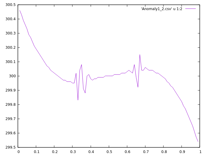

Hello Everyone,
I am currently running Rayleigh Benard Natural Convection simulations. Ra 1e5 and Pr 0.025
I have encountered a strange error in temperature profile. I am noticing these rings along the plumes of upward flow i.e. Mushroom like structures in temperature contours. I have attached a plot of the temperature across the observed ring.
Also I would like to point out that the structures/ perturbations in temperature are observed only for Pr 0.025 cases. The rings/perturbations are no observed for Pr 0.7 or 0.006. Also I would like to add that the overall profile of the temperature on averaging across the domain along x-axis is slightly affected and can be observed only at a closer look. I just wanted to know what could be causing it and what can be done to avoid these in future ?
Heat flux model - AFM
Turbulence model - RSM:EB
unsteady RANS
