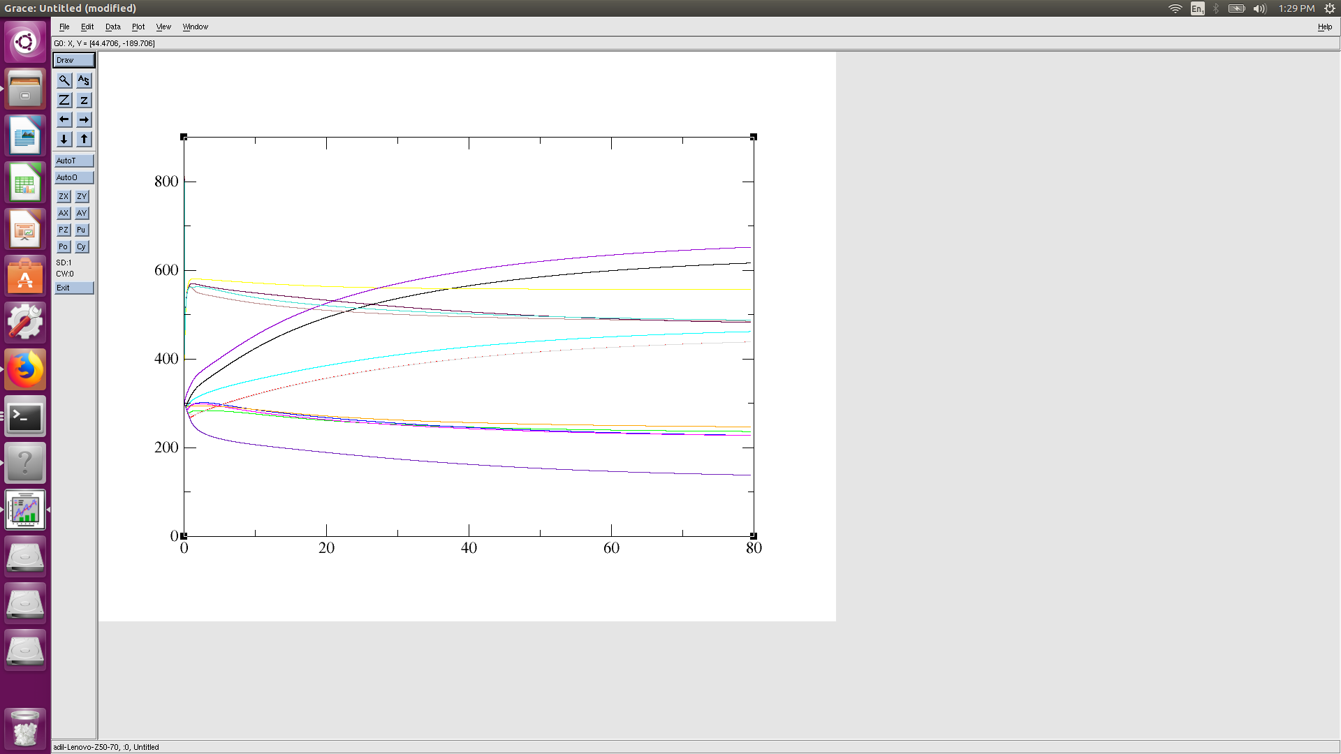

Thank you Antech
the solution is showing signs of convergence but I think it will require a lot of iterations. Currently I have run 80,000 iterations with a time step 0.001 and my temperature is very slowly showing signs of leveling off (image attached). I will try a few other techniques that you have mentioned to see if i can get closer to converged results. If you have any other recommendations, much appreciated.
Thank you for the help
