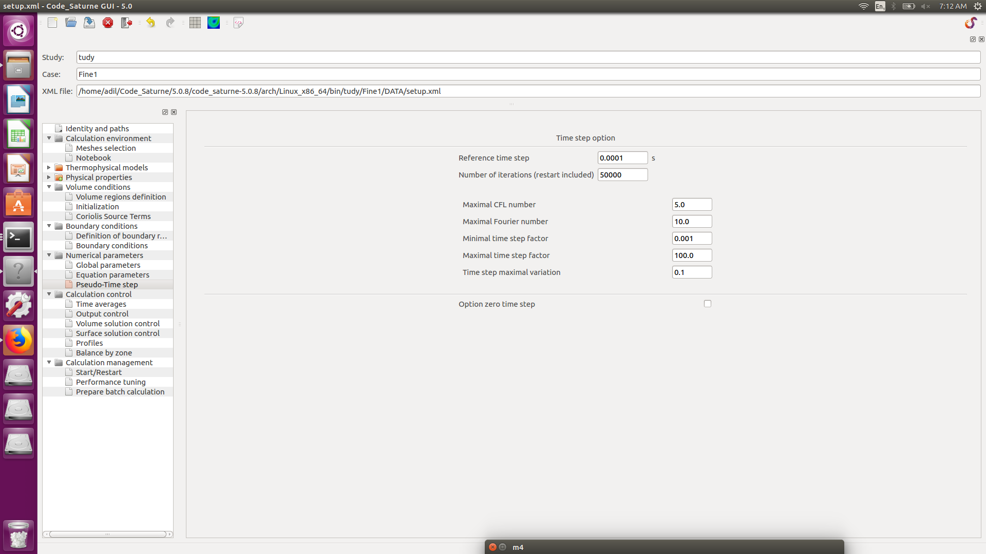

Thank you Antech the solution is showing signs of convergence but I think it will require a lot of iterations. Currently I have run 80,000 iterations with a time step 0.001 and my temperature is very slowly showing signs of leveling off (image attached). I will try a few other techniques that you have mentioned to see if i can get closer to converged results. If you have any other recommendations, much appreciated.
Thank you for the help

Hi there again Antech,
I have taken on board what you have said, but still require at least 50,000 iterations for convergence. My model is simulating a segment inside a nuclear reactor core, maybe the extreme conditions it is subjected to mean a a greater number of iterations than predicted.

Your settings look good, IMHO. Maybe there's indeed a specific conditions that require so many iterations. We usually work with aerodynamics and conjugate fluid/solid heat transfer now, so our conditions are very different from yours (at least the fluid density, because, I guess, you work with water while our fluids, in Saturne cases, are mostly air and industrial gases). I use different meshes, including meshes with local areas of small elements, so I don't think that it's related to mesh. Without the case files I cannot say more specific, may be, Ivan will give you some suggestion.
