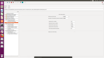

Hi everyone i have two questions. Firstly my current simulation comprises of 3200 elements but requires convergence of both energy and momentum take 50,000 iterations to converge. Is there any way I can reduce this as I am carrying out a mesh independent study and require analysis of finer mesh with smaller time steps and much larger computational power?
(I have attached my steady state time step parameters if it helps)
Thank you in advance

Just a quick update, I have had to decrease the time step to 1-e05 to avoid divergence for my finer mesh models due to a very low y plus (10e-06) at the boundary. As a result i believe several hundred thousands of iterations will be necessary for convergence now. Any suggestions.
Posts: 4082
Re: faster convergence
Posting more info (as per the forum rules/recommendations) would help get a bigger picture of what is slowing you down. Info on the mesh quality (or even the mesh, as it is very small) would also be useful for starters.
But in any case, such as small y+ is not useful, and will force you to slow the computation. Having a locally small y+ (due do velocity being small or zero in re-circulation regions for example) is OK, but having excessive refinement in the wall region is not useful. So the issue is probably related to your mesh.
