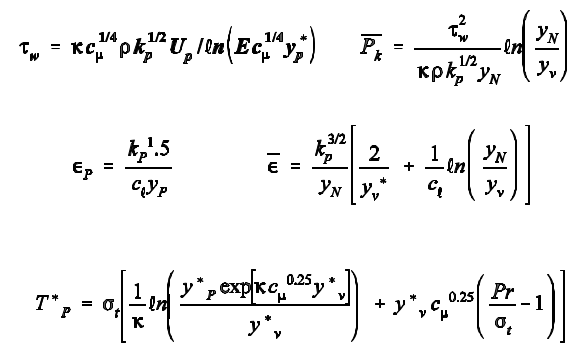

Hi,
I have read the clptur.f90 but I need some explanations.
Firstly, I was looking at the formulation of the standard wall from the literature function and the one implemented in Code Saturne. My question is where are the Pk and average epsilon terms go in the code if the are the same ?
These terms appear also in the of Craft and Gerasimov et al.(2002) and should be incorporate in k and epsilon equation as source terms .
From the code in the clptur.f90 file I figure that the velocity boundary section concerning (pimp and qimp) should be somehow modified and similarly for the k -epsilon boundary section .
Are those terms found in the turbke.f90?
My simulation: simple channel flow with periodicity and pressure gradient imposed.
Thank you in advance,
Costas

Those 2 layers "standard" wall functions are not the one implemented in the code. Again, please have a look at the Theory guide that you can access via the command line I gave you before or here. This will give you an overview of what is implemented in clptur.f90 and cs_wallfunctions.c/.h
As explained in the theory guide the production is controlled via the cofimp coeffcient.
If you want to explicitly impose a source term as the production, then you can modify Ptheo in the theory guide and derive a new cofimp that corresponds to what you need.
Also it is always possible to modify the source term directly in the turbke routine in a first attempt.
