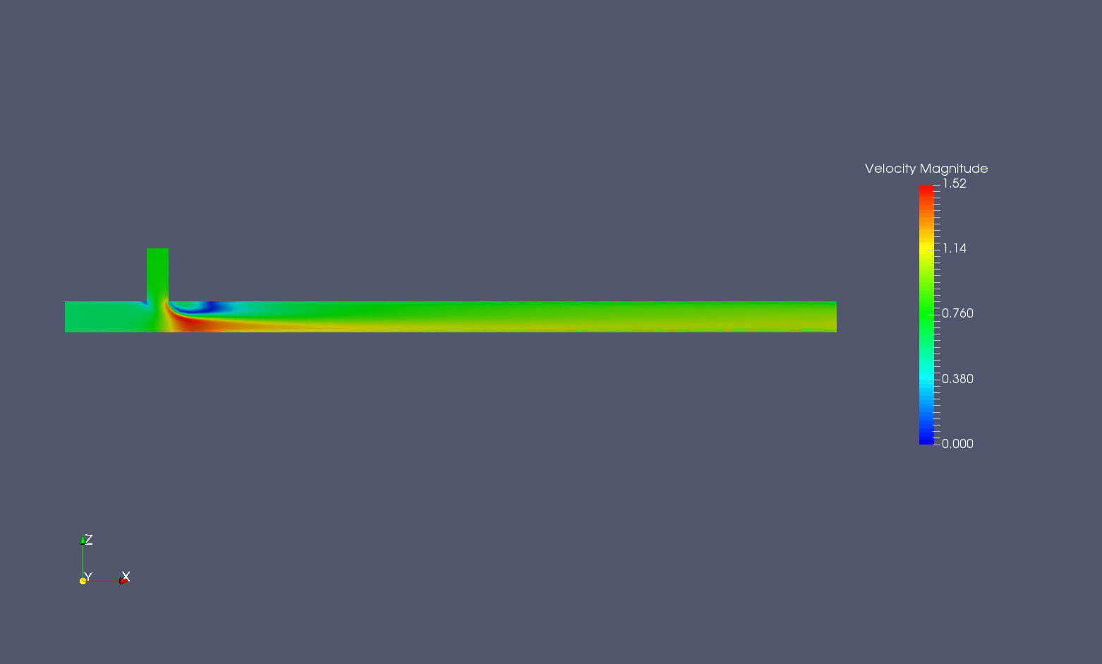

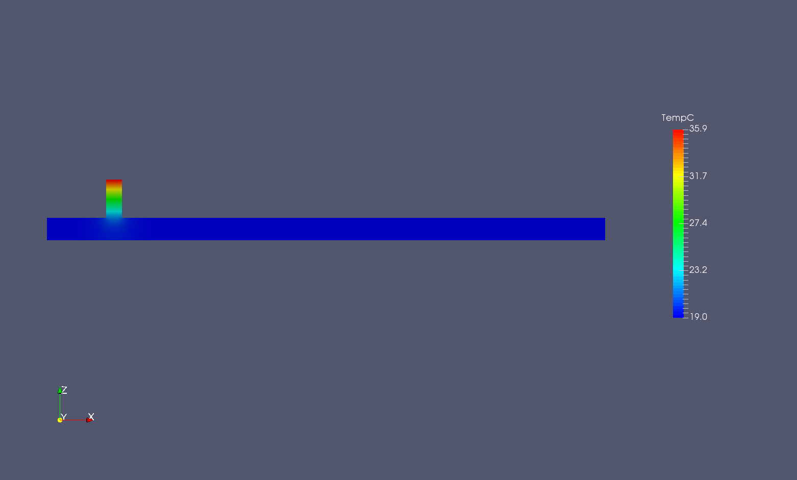

Dear all,
I have performed the tutorial "Turbulence simulation in a mixing tee" available in the documentation folder of the Code_Saturne site using the 64 bit Window 5.0.9 version of CS. The velocitiy calculation is OK, I get a very comparable result (see annex "Velocity.png"). Unfortunately, the temperature calculation is wrong (see annex "Temperature.png"). This result is more related to a stationary heat conduction problem with no flow, rather than a convective thermal flow problem. I have performed the same tutorial set-up and calculation using the Linux-version of CS 5.0.9 and the results are all OK. I then used the previouw Windows version of CS (4.0.8) to run the same tutorial and the results are also OK. So, only the Windows version of CS 5.0.9 is not giving the expected results. Does anyone else also experienced this problem? If not, can somebody help me figuring out why the temperature calculation is wrong using the latest Windows version of CS?

Regarding this Windows version. Try an absolutely new case, use first order (upwind) scheme for velocity, steady flow, adaptive timestep with target Fourier and Courant numbers of around 10. Set the velocity at inlets to 5...10 m/s. Run it, let it to converge (let it run for 100...300 iterations). Then check the temperature field. That on you picture is absolutely wrong, it must not be so. If you get the same problem it's likely that there is a bug in this particular version for Windows. It's likely that Ivan will help you to cope with it but it may be not simpler than to create a Linux setup and be able to run any version including newest. And there may be other issues. I recommend to switch to Linux (on separate SSD or hard drive).

Many thanks for your reply. I had also tried the other settings you suggest, but the calculated temperature profile was also wrong. So I guess there is really a bug in the latest Windows version. Regarding Linux, I know that this OS is much better for performing these calculations using EDF software, but the research lab I am working at is relying on Windows OS. So I hope the developers working on the Windows port will solve this bug in the near future.
