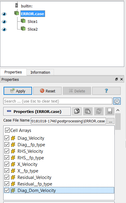

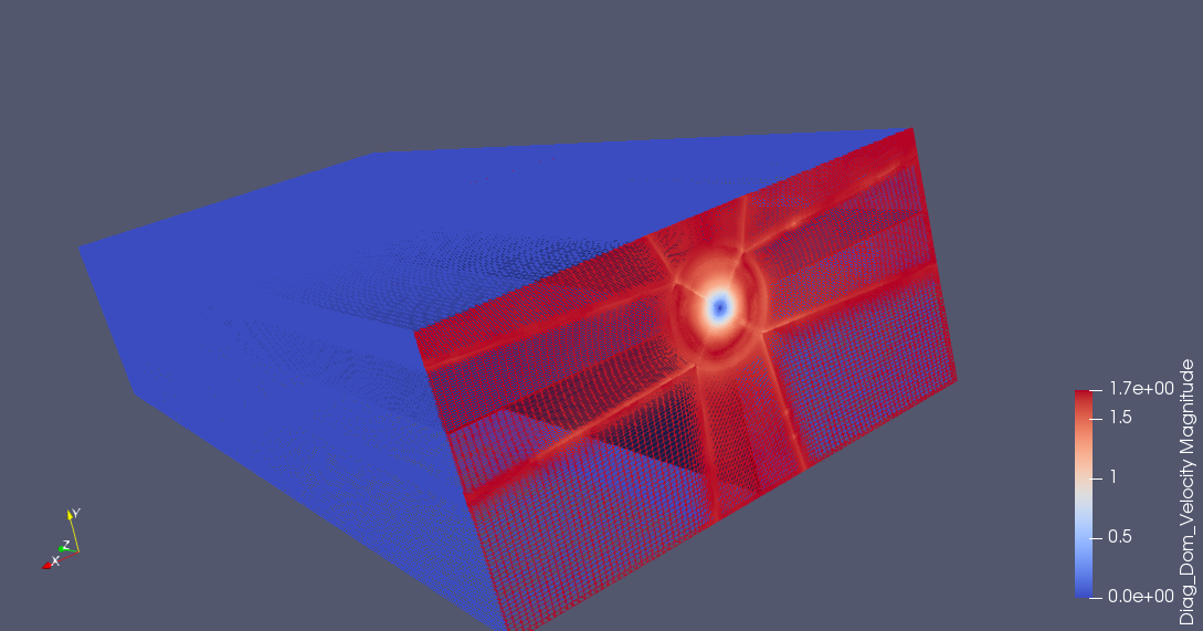

By looking at the ERROR.case I could look into the quantities appearing in the ERROR.png (see attached).
Please find attached the most significant images I post processed from the ERROR.case in paraview.
Diag_dom_velocity and X_vel_2 are significant at the outlet
Regards
FA

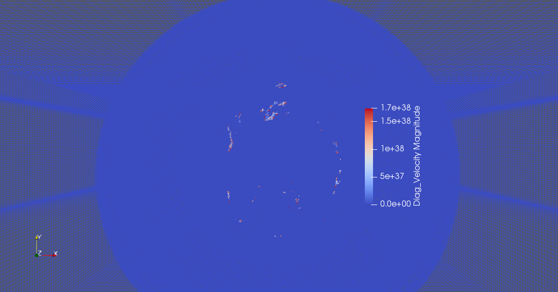

and "Diag_Vel_magnitude" at the interface between rotor and rest of the tank.
FA
FA

The "Diag_Dom" (diagonal dominance) actually makes the easier for the linear solvers to converge, so we usually check it does not become negative anywhere (which could be related to a mesh quality or other problems, so as some implicit source terms destabilizing rather than stabilizing the system, or other numerical issues).
Does the right-hand-side (RHS) already contain very high or irregular values ? This could be the case if divergence appears progressively over several time steps.
Is your mesh still the one you linked to in an earlier post or a newer one ? I may be able to test your case next week.
