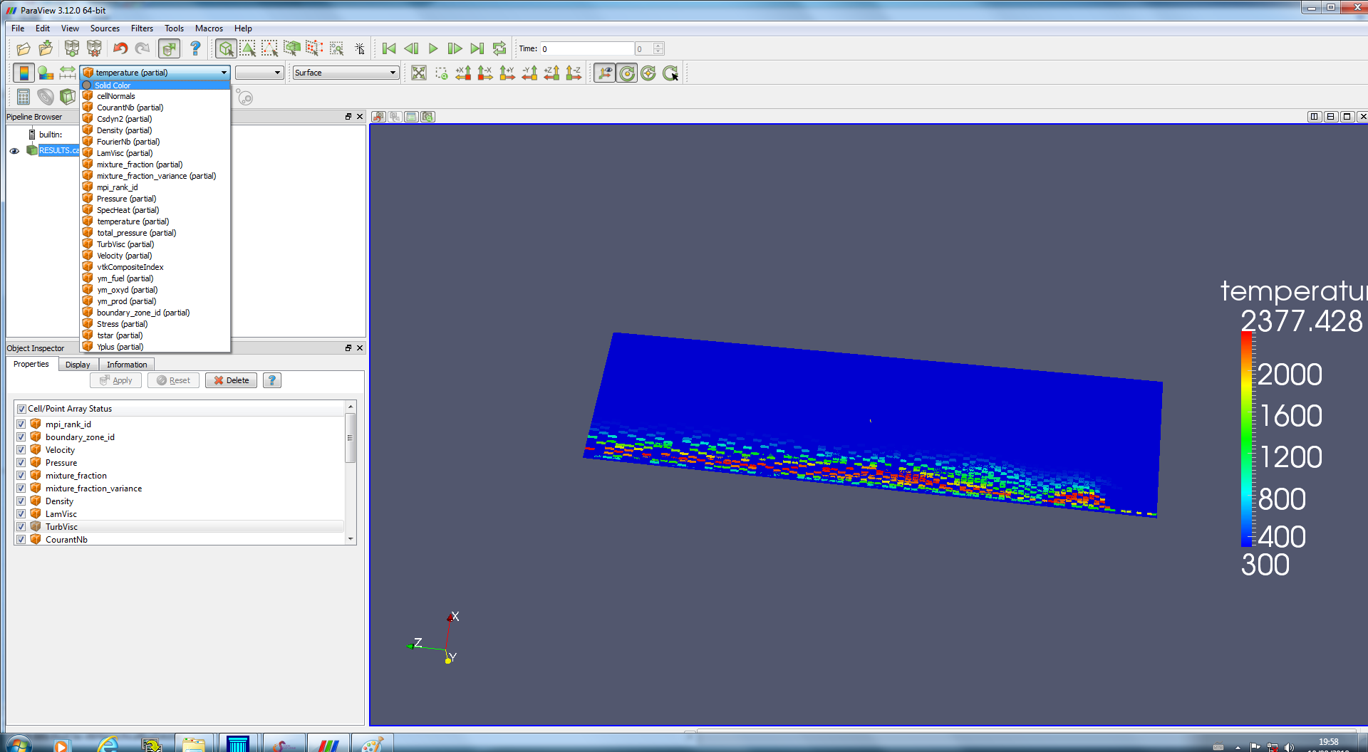

i did the simulation of the combustion of propane using code saturne 5.0.8;
but i have problems to visualize the results in paraview.

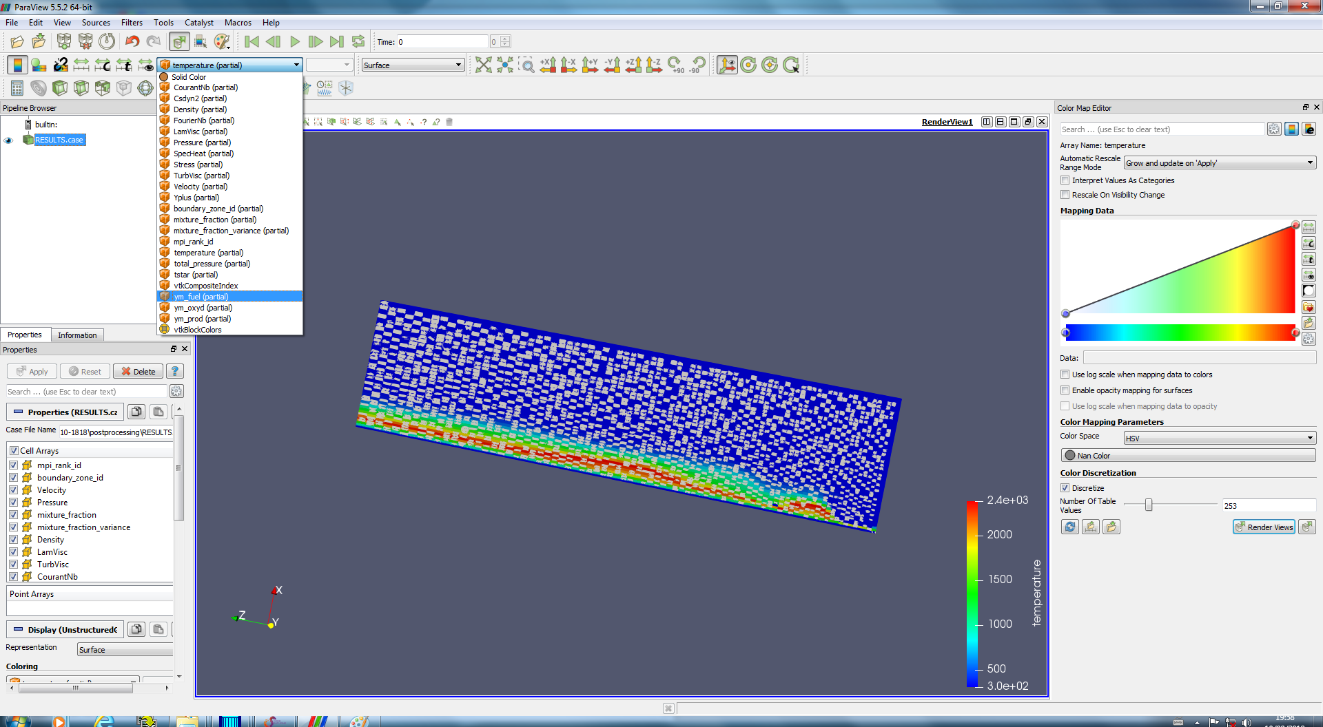

the figures don't appear well as you can see on the files I attached.
what I also noticed is that, beside every quantity, the word (partial) appears in bracket.
i'm wondering what the partial in bracket represents.
i would like to remove it
visualisation of results using paraview

Re: visualisation of results using paraview
You either need to use the "separate meshes" option for the EnSight writer in Code_Saturne, or the "extract blocs" filter in ParaView.
good morning
thank you for the information;
the problem is solved
