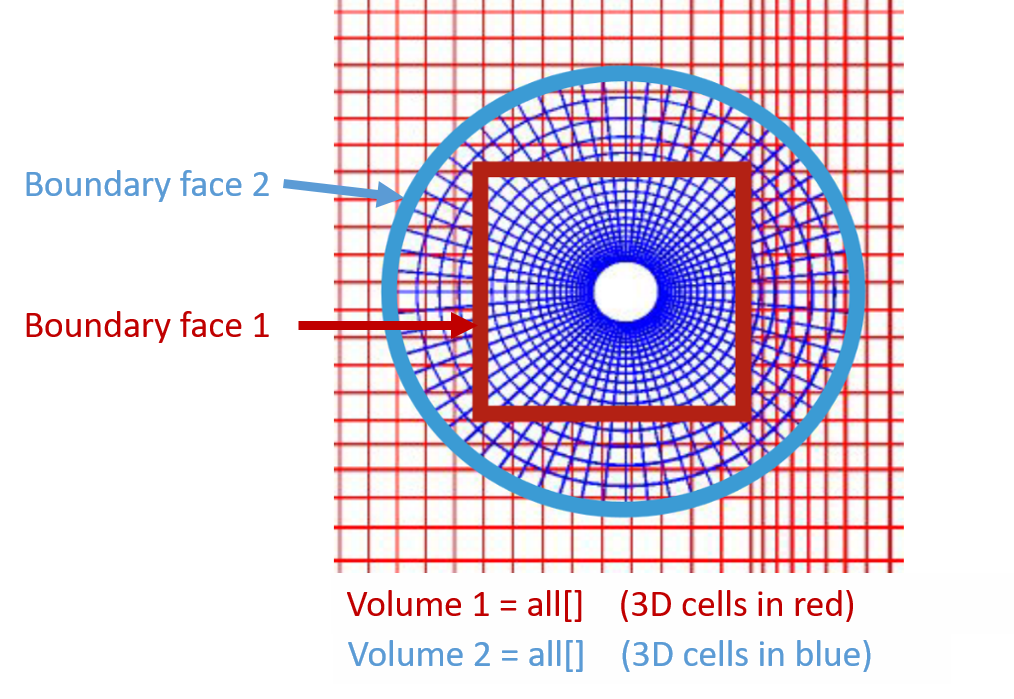

I'm using the 5.0.4 version. To be sure, we're talking about the same thing, I found a image from a Code_saturne presentation.
For domain1 (blue):
- boundary_sup_criteria = boundary face 1 (not functional according to the user guide 5.0.0)
- volume_sup_criteria = all[]
- boundary_cpl_criteria = boundary face 2
- volume_cpl_criteria = all[]
And vice versa for domain2.
Is this correct ?
Best regard,
Paul
Posts: 4215
Re: Deformation and Big displacement
Yes, this seems correct.
