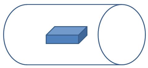

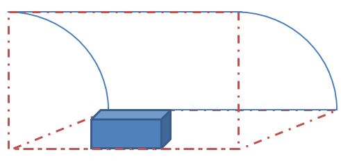

I have also a little question about symmetries :
Is the previous picture equivalent to the following one ? (the dotted planes are the symmetry planes)
(just to ensure that code_saturne support those two symmetric planes as it should be mathematically).
Quentin
Posts: 4289
Re: Outgoing flow
Yes, this should work. We have some minor precision issues with this type of symmetry, so using a rotational periodicity may be an alternative, though it is computationally more costly.
