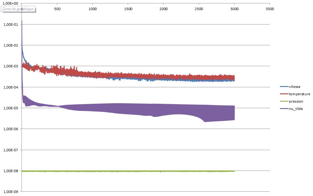

I have some interrogations about convergence, i am trying to reproduce some results from an article (which gives HTC and temperature from a cube heated in an air flow) but the results I obtain are not really equivalent. Moreover my residuals are not in the usual range (under 10^-6).
Here is a picture of my norm residuals :

But speaking about convergence, do you have any idea why my norm. residuals are so high compared to the 10^-6 criteria ? Do I have to change something in my simulation parameters or so ?

By default in CS 5.0 the precisions are the following (you can view in setup.log)
epsrgr 1e-05 Gradient reconstruction precision
epsrsm 1e-07 Rhs reconstruction precision
epsilo 1e-08 Resolution precision (Iterative solver)
You can try to change these values using the subroutine usipsu inside of the cs_user_parameters.f90. Also, you only set one monitoring point upstream of the square block, I think that you have to set more monitoring point downstream of the block where the turbulence plays a fundamental role. Also, try to change the turbulence model (K-epsilon, K-omega).
