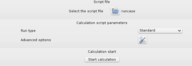

I just installed the CS 4.0 version on OpenSuse 13.2,
I set a quick test to check if everything run well, but when I was in the Prepare batch calculation section I did'nt have the number of processors option..
The calculation ran well without any problem, but I would like to be able to decide how many processors I want to use.
Does anyone know why I am not able to choose the number of processors, and if there is a way to correct it ?
