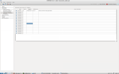

I've run the solid case independently in Syrthes without any volumetric source term, and it just goes fine. But after I set a volumetric source term which is a heat generation term varies along axial (z) direction, and when I run the simulation, it failed. Is there some mistakes during my setting? It's just a simple function. Thank you!

Did you solve the problem? If not check the stderr.txt file for more information. Also, you can check the in the user_fct.c file (void user_cfluvs_fct() ) if the data that you input throught the GUI were setted.

I did "solve" the problem, by replacing (z/8.32)^2 with (z/8.32)*(z/8.32), as I realized that the function complier doesn't recognise the "^". Thanks.
