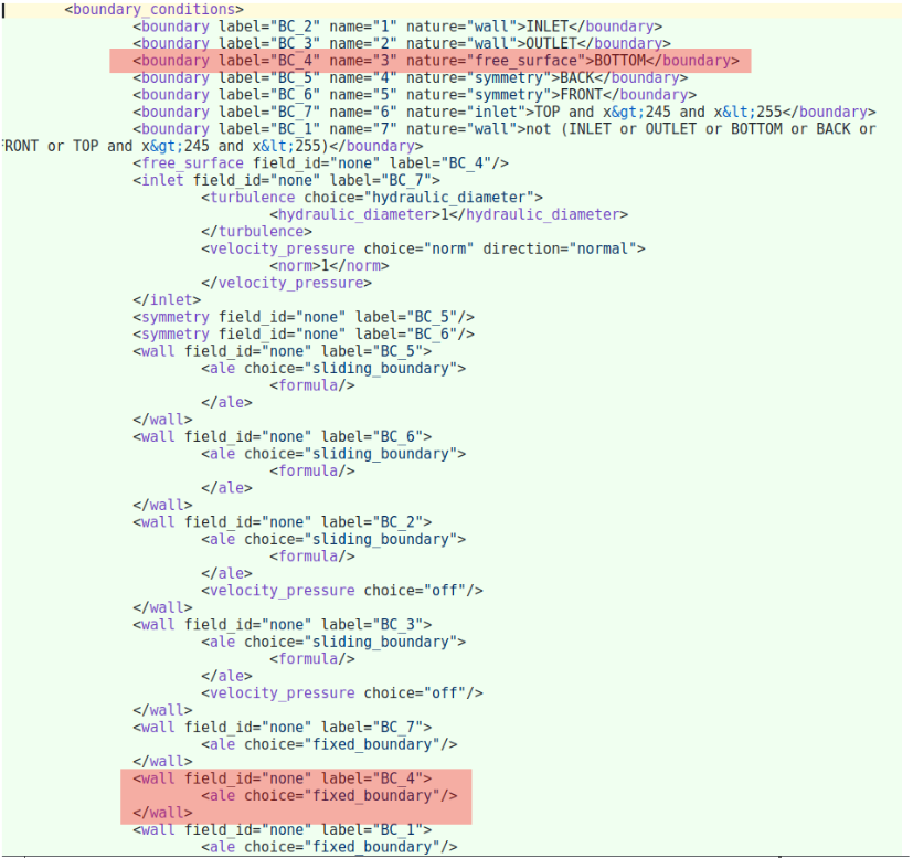

I was trying to run your case and I think that my previous appreciation about ialtyb(ifac) -> itypfb(ifac) was wrong. I think that maybe can be a bug in the GUI. I create a new case with CS 5.0.8 and after set the free surface and all the BC's, the result was that the free surface doesn't move.
Looking at the XML file I found that the BC corresponding to the free surface was set with "fixed boundary" (figure attached).
If I remove the section
Code: Select all
<wall field_id="none" label="BC_4">
			<ale choice="fixed_boundary"/>
		</wall>
The free surface move with the fluid velocity. If I do any modification in the GUI, after save the case, this section is added again.
In the case that you attach also the free surface is set as fixed boundary in the ale choice.
