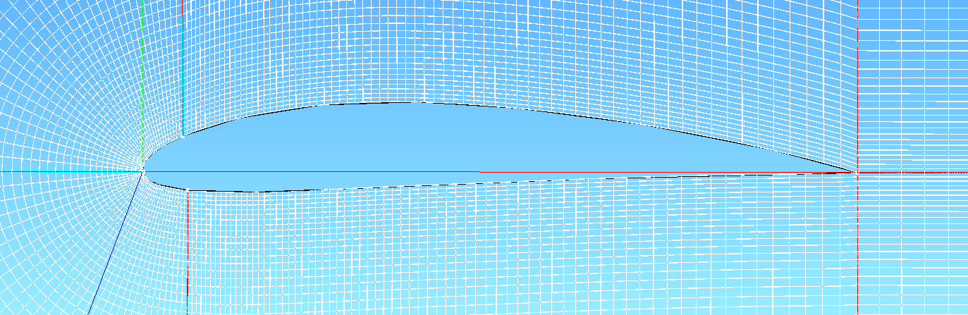

I have some problems with the definition of boundary conditions in code_saturne. To create the mesh (with Salome 7.6.0) I did some partitions of the flow domain (partition faces are the red lines in the attached screenshot).
How can I define the BC's on these faces? If I define them as "free inlet/outlet" the simulation doesn't work. And there are not really that much choices =/

These faces should not be boundary faces, but internal faces (partitioning under SALOME is an intermediate step, to prescribe geometry constraints, but does not mean the final mesh should be split in disjoint parts). Under SALOME's SMESH, you can use "merge nodes" to merge the nodes from the partitions. Otherwise, under Code_Saturne, use mesh joining (selection criteria "all[]" if you can't do better) in the preprocessing stage.
