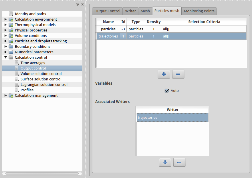

Hi Yvan,
Thank you. After creating a trajectory writer and associating a trajectory mesh to it (see attached pictures), I should have trajectory files (trajectories.00001, trajectories.00002, trajectories.00003, ...) generated in the postprocessing directory, right? But, I don't see such files being generated. I use v4.0.5 on Ubuntu. Thank you for helps.

Re: Plotting particle trajectories in ParaView
You also need to set the type of the trajectory writer to "trajectory" (and not particles). The type is actually more important than the name.
Thanks. I get trajectories now.
