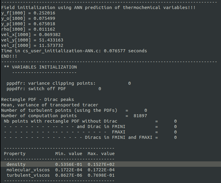

Did you check the return codes for calls to fread and fopen, to make sure data is read correctly ?
What are the min/max/mean values indicated in the run_solver.log at the computation start ? Maybe data is read and reinitialized for this model (that would be considered a bug).

I did check whether data have been correctly read, and it seems like a sort reinitialization takes place since, as you said, there seems to be not a correspondence between min/max/mean values. I attached a snapshot of my run_solver.log.
