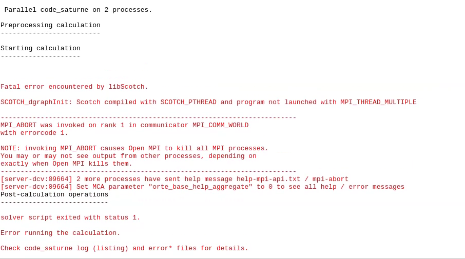

The problem happens when the case is launched on multiple cores :
1 - On the GUI terminal, I had the following error (cf code_saturne_error).

Do you use a packaged Scotch install or did you build your own ? I invite you to read the notes regarding Scotch build options in the code_saturne installation documentation : https://github.com/code-saturne/code_sa ... INSTALL.md.
Unfortunately, there is no function in Scotch that I know of (unless I missed recent updates) for querying whether Scotch was build with threading support or not, and adapt the MPI_Initialize method accordingly. And since this can degrade performance on may MPI implementations, I would rather lose a bit of performance with unthreaded Scotch one per run rather than in the code_saturne algorithms for the whole run...

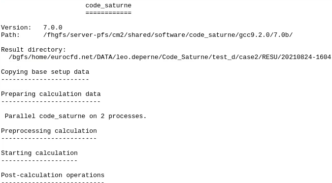

With slurm, I add the "code_saturne.cfg" file and just modified "batch = SLURM". It works fine on one proc, but nothing on 2 or more.
I have no listing file, nothing written in the error slurm log, and here is what I get on the output log file :
