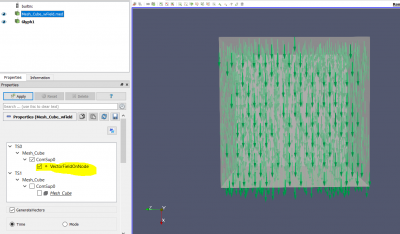

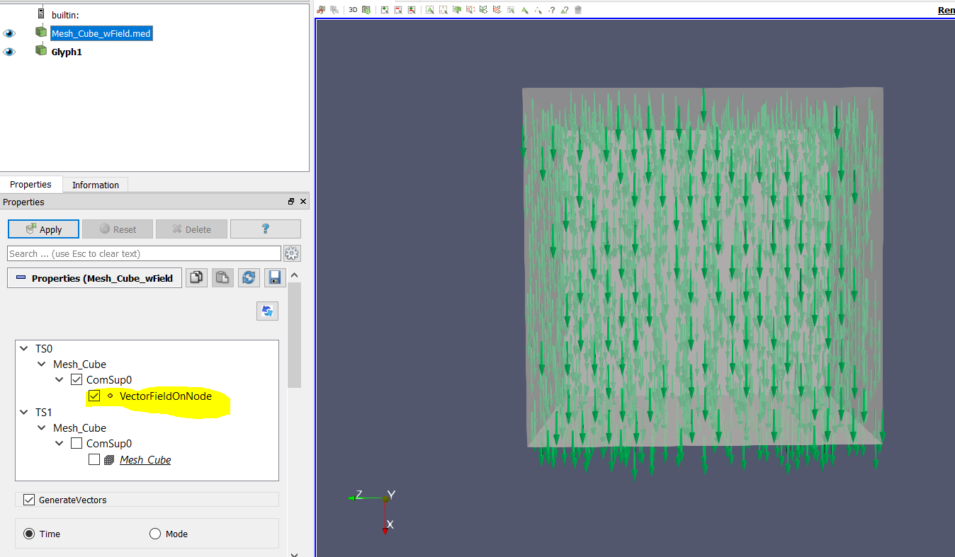

from MEDCouplingRemapper import *
import medcoupling as mc
import MEDLoader
import numpy as np
import csv
Path = ".//01_Data//Geometry"
file = Path + "//mesh.med"
#mesh=MEDLoader.ReadUMeshFromFile(file,"Mesh_Cube",0)
#Numofnodes = mesh.getNumberOfNodes()
#idx = list(range(0,Numofnodes,1))
#vec = np.random.randint(100, size=(Numofnodes, 3)).ravel().tolist()
vec = np.array([np.ones((1,Numofnodes))*0,
np.ones((1,Numofnodes))*9.8]).transpose().ravel().tolist()
print(vec)
fieldOnNodes=MEDCouplingFieldDouble.New(ON_NODES,CONST_ON_TIME_INTERVAL)
fieldOnNodes.setTimeUnit("s") # Time unit is seconds.
fieldOnNodes.setStartTime(0,2,-1)
fieldOnNodes.setEndTime(60000,2,-1)
fieldOnNodes.setMesh(mesh)
fieldOnNodes.setName("VectorFieldOnNode")
array=DataArrayDouble()
array.alloc(fieldOnNodes.getMesh().getNumberOfNodes(),3)
array.setValues(vec,Numofnodes,3)
fieldOnNodes.setArray(array)
MEDLoader.WriteField(Path+"//Mesh_Cube_wField.med",fieldOnNodes,True)

const cs_real_t *cell_f_vol = domain->mesh_quantities->cell_vol;
/* Density */
const cs_real_t *cpro_rom = CS_F_(rho)->val;
const cs_real_t ro0 = cs_glob_fluid_properties->ro0;
/* const cs_real_t *cvar_pr = cs_field_by_name("pressure")->val; */
/* const cs_real_3_t *cvar_svbf = cs_field_by_name("VectorFieldOnNode")->val; */
/*cs_property_t *pty = cs_property_by_name("VectorFieldonNode"); */
const cs_real_t *cvar_svbf = cs_field_by_name("VectorFieldonNode")->val;
if (strcmp(f->name, "velocity") == 0) {
cs_real_3_t *_st_exp = (cs_real_3_t *)st_exp;
/* apply source terms to all cells */
for (cs_lnum_t i = 0; i < n_cells; i++) {
/* _st_exp[i][0] = cell_f_vol[i] * cvar_svbf[i][0]*cpro_rom[i];
_st_exp[i][1] = cell_f_vol[i] * cvar_svbf[i][1]*cpro_rom[i];
_st_exp[i][2] = cell_f_vol[i] * cvar_svbf[i][2]*cpro_rom[i]; */
_st_exp[i][0] = cell_f_vol[i] * 0*cpro_rom[i];
_st_exp[i][1] = cell_f_vol[i] * 0*cpro_rom[i];
_st_exp[i][2] = cell_f_vol[i] * 9.8*cpro_rom[i];
/home/App/code_saturne/code_saturne-7.0.2/src/base/cs_boundary_conditions.c:699: Fatal error.
Some boundary condition definitions are incomplete or incorrect.
For details, read the end of the calculation log,
or visualize the error postprocessing output.
Call stack:
1: 0x7f40880afc74 <cs_boundary_conditions_error+0xa4> (libsaturne-7.0.so)
2: 0x7f40887fb8c5 <__cs_c_bindings_MOD_boundary_conditions_error+0xe> (libsaturne-7.0.so)
3: 0x7f40881f10ad <vericl_+0x47fe> (libsaturne-7.0.so)
4: 0x7f40880701c3 <condli_+0xf41> (libsaturne-7.0.so)
5: 0x7f40881df5b8 <tridim_+0x2a64> (libsaturne-7.0.so)
6: 0x7f408804fc94 <caltri_+0x1c2f> (libsaturne-7.0.so)
7: 0x7f4088f1bb72 <main+0x712> (libcs_solver-7.0.so)
8: 0x7f4087db90b3 <__libc_start_main+0xf3> (libc.so.6)
9: 0x56236ae440ce <_start+0x2e> (cs_solver)
End of stack
Thanks for your helps!
Regards
ywan459
