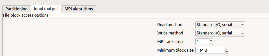

I have faced the same issue as you in one of our clusters with CS 6. I think that the problem is during the writing of the restart files.
The solution that I found was to change the input/output method, from default to serial I/O.
Luciano

Hello Luciano,
I indeed saw (before creating this new subject) your post on the forum related to your restart issues.
I misunderstood the solution you found: I tried to change the read method, and not the write method... Actually I have just done a test changing both methods: the restart seems to work correctly!
Thank you for your help!
