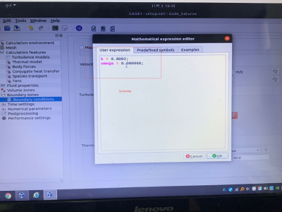

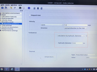

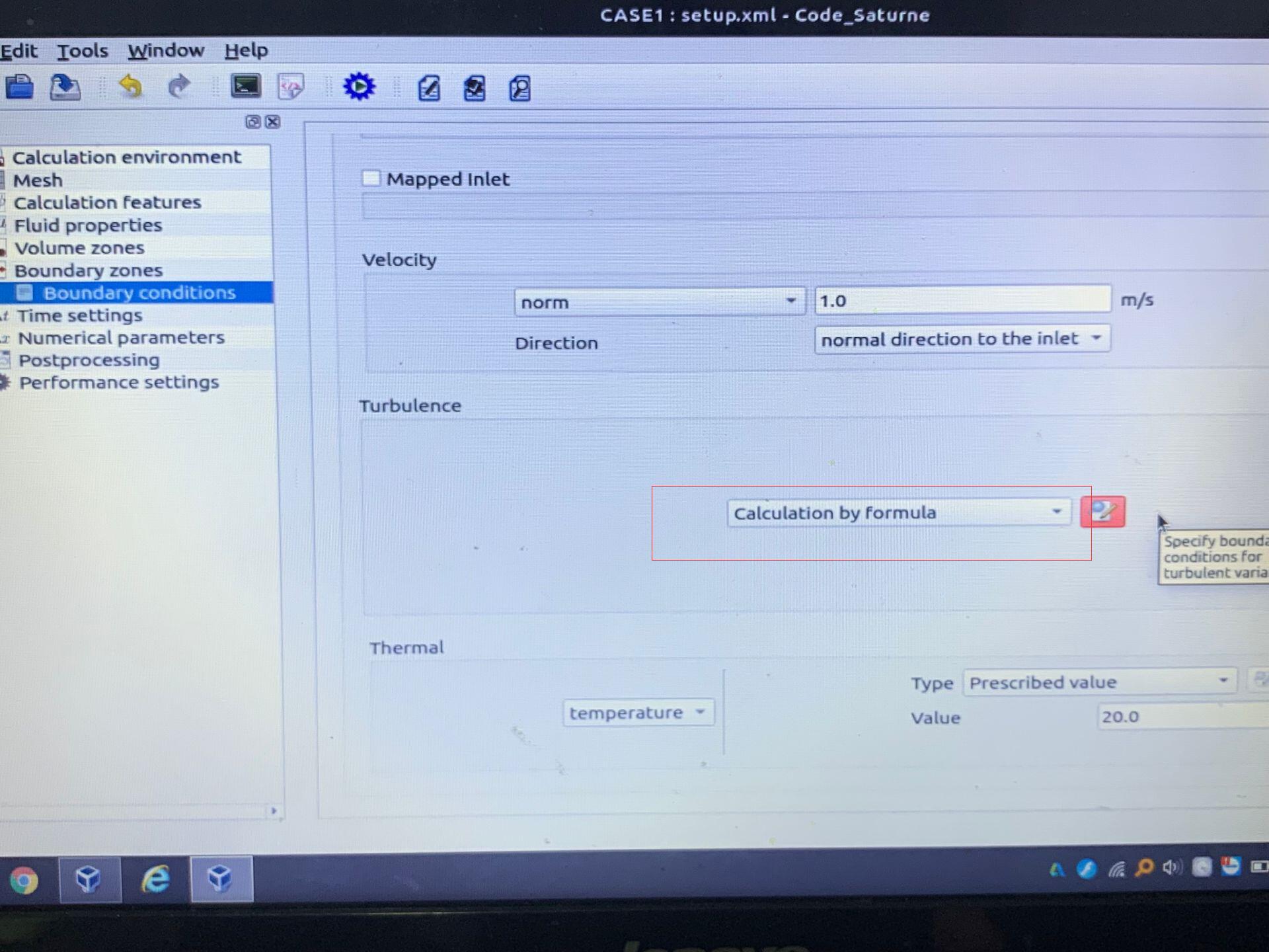

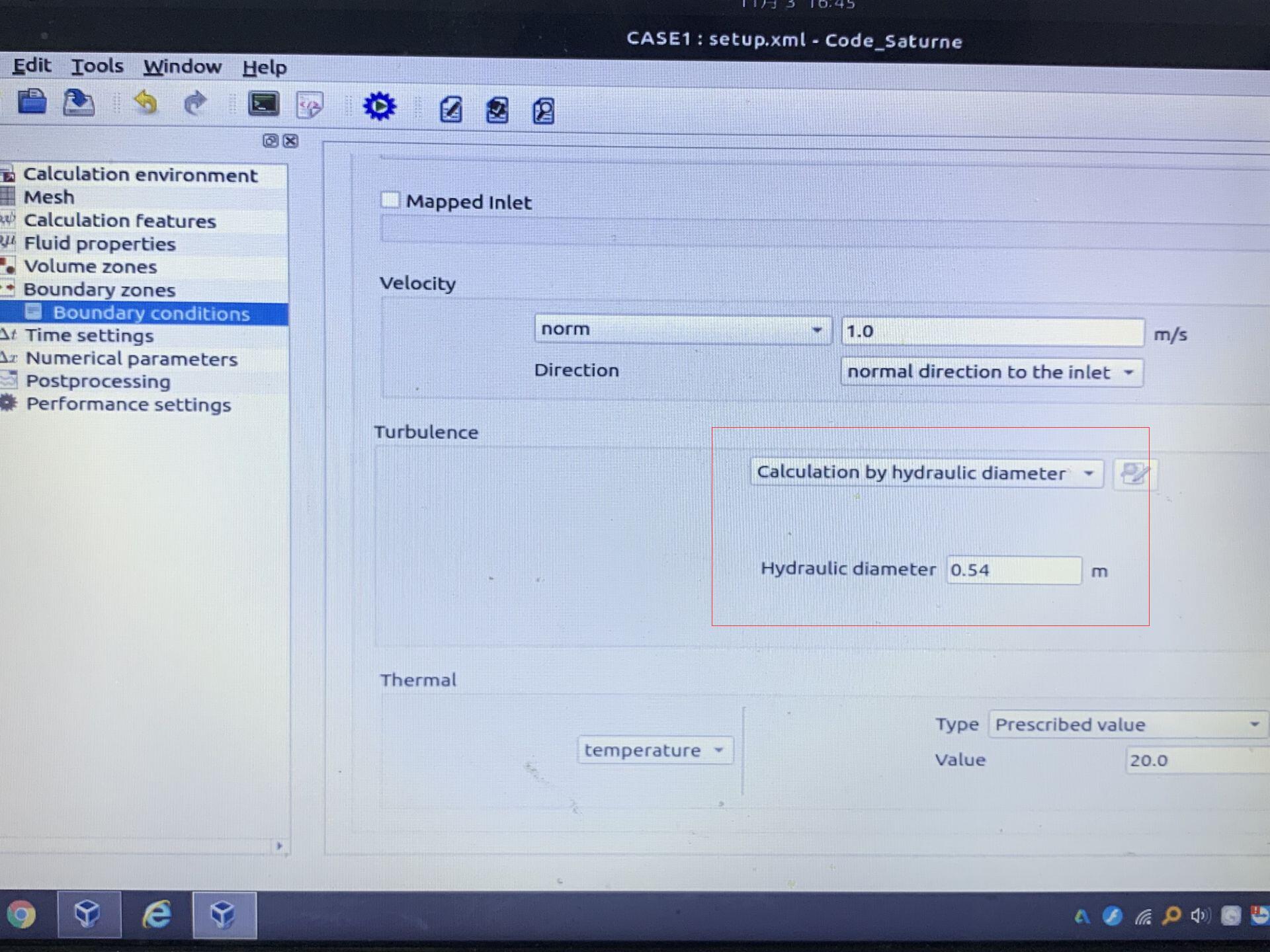

Recently I simulated a water tank.
the tank is about 50 meters long, 4 meters wide, and the high (water depth) is 0.54 meters.
I chose the K-W SSTmodel as my turbulence model.
when I set the boundary conditions, I find that I can choose two types, one is the turbulent calculation by formula (k and w), another is a calculation by hydraulic diameter.
I think the tank is enough long and wide, so I can think this tank is a Wide shallow open channel,because the water depth is small in comparison to wide and long. so I would like to set the water depth as hydraulic diameter.
But I also have the value of the k and w.
so it means that I have two choices.
I don't know my understanding is correct (attached the screenshot)
how should i choose the inlet turbulent in boundary conditions?

Re: how should i choose the inlet turbulent in boundary conditions?
hello!
Thank you for your answer.
In my understanding that I can choose the water depth or the k-w, only depending on which one I have. is it correct?
In my case, I want to simulate the one direction flow. so I think in my inlet, it has the flow come in.
I don't know if I understand your question?
Best wish,
Yvonne
Best wish,
Yvonne
