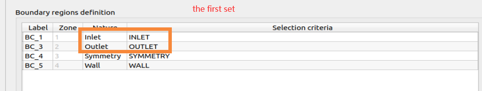

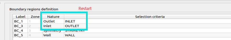

you know the tidal flow has different directions. I want to simulate twice cycle period. it means I should change the inlet boundary condition to the outlet boundary condition.
I don't know the code_saturne has the function to change the boundary criteria. if not, I want to use the "restart" function. when I turn on the restart, I can choose the last case result->checkpoint as the boundary conditions. And the same time, I would change the inlet as an outlet, an outlet to an inlet when I can think that the tidal flow has turned the directions. then run the case. can I consider that it is a hot start?

Dear Yvan.
I don't know if I've made myself clear or understood you, so I'd like to make sure.
It means I can't change the boundary conditions like the screenshot(attached the picture)
And I can set a boundary in the first simulation and then use the same mesh and physics parameters in "restart", just changing the boundary properties in the file cs_user_boundary_conditions.f90 ( Change nature inlet to outlet).

- Posts: 4074
Re: code_saturne restart
Yes, you can change the boundary condition types for a restart. At least I think it should work.
When in doubt, try it and check the results.
