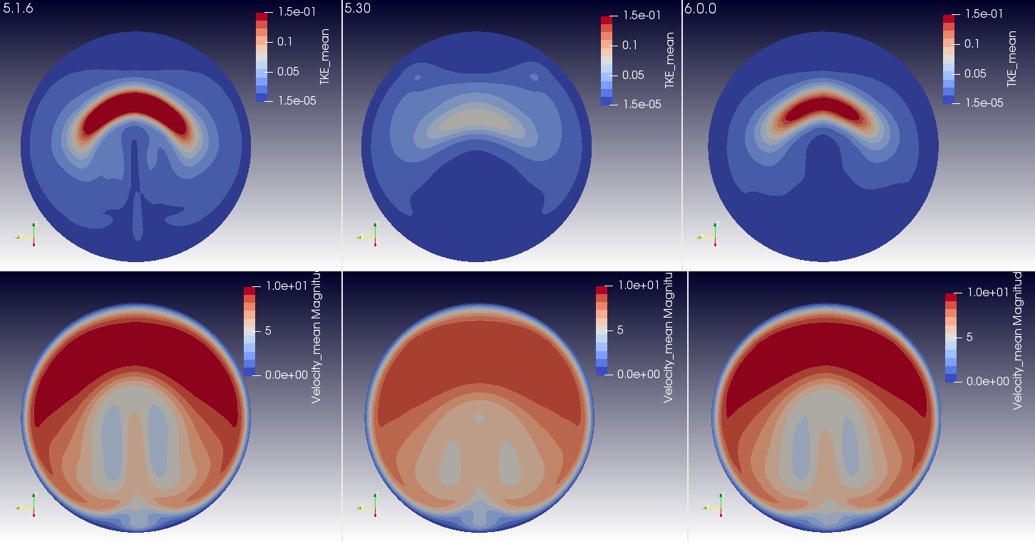

I've tried ton run the case with the 6.0.0 version.
I can show you a slice in the hole of the jet
The results of the 6.0.0 are close to the 5.1.6 (perhaps the discrepancy is related to time averaging or linear solvers).
The 5.3 gives weird results, with an under estimation of the velocity and the turbulent kinetic energy...
Do you have any idea ?
Thanks
Franck

Looking at the release notes and git commit history, I don't see anything obviously related, but there were many small changes and bug fixes, so short of a full bisection (which may not be a priority for anyone), I can't be sure.
Not sure I understand if results are time-averaged or not.
I can asks colleagues if they remember a specific change.

The result are time-averaged. It was done over the same time period and the same time step.

It may be interesting to use multiple cuts, to see if the structure is simply "shorter" in v5.3. That would still not explain why you have different values, but maybe help evaluate how strong is the difference.
