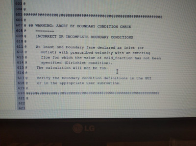

I tried to find solution but without success. Every time I get the warning that you can see in attachment.

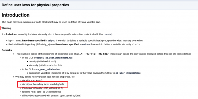

In documentation of Code Saturne I found that is possible to set the density on boundary faces but I don't know if it is what I need and it don't works me.
