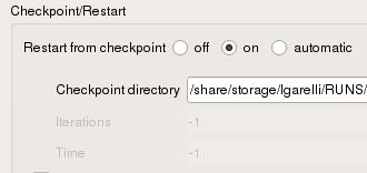

I'm having problem to restart a simulation from a previous one. When I select the checkpoint directory I don't get the information about the last time step and physical time. When the new simulation is lauched the freeze after the read mesh process. The previous simulation finished correctly without errors.
The simulation was runned with CS 6-beta and I use the checkpoint_time_step in the control_file to force a specific checkpoint step

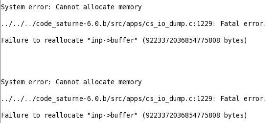

In the terminal I get the following error Is there any way to recover the data?
