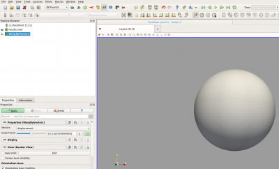

i want to know use which Filters see the result about free surface mesh motion?

I assume that you have a displacement vector as result of the CS simulation, so you can use the "warp by vector" filter. Also, you have a scale factor parameter to "scale" these displacement. Regards,

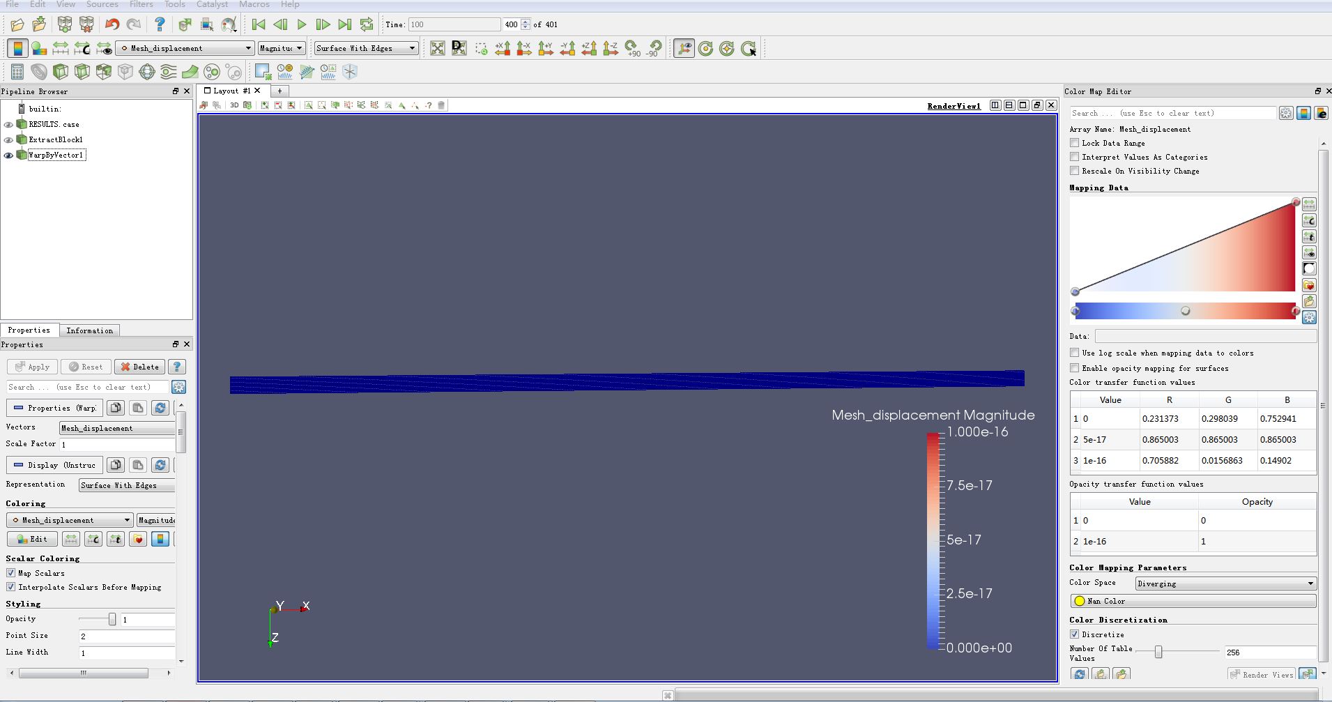

Hello Luciano,
I used your xml file, but in the postview processing, I didn't get the free surface effect. Is there a problem with my settings in paraview?

Check if in your XML file in the DATA directory there is a block of code like this for the BC_4
If there exist, remove it, and the run the simulation without saving in the GUI. Other option is to compare the two XML (the file that I upload and the file that you have in the DATA directory).
Luciano
<wall field_id="none" label="BC_4">
<ale choice="fixed_boundary"/>
</wall>
