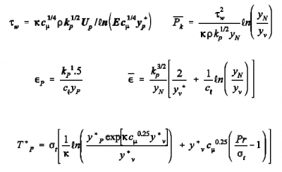

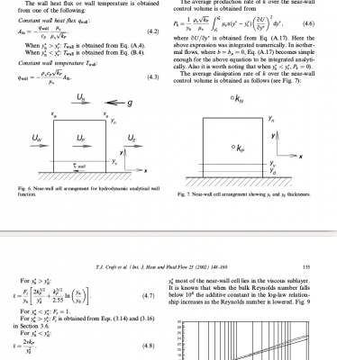

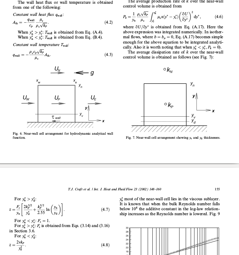

Firstly, I was looking at the formulation of the standard wall from the literature function
and the one implemented in Code Saturne. My question is where are the Pk and average epsilon terms go in the code if the are the same ?
These terms appear also in the of Craft and Gerasimov et al.(2002)
and should be incorporate in k and epsilon equation as source terms .
From the code in the clptur.f90 file I figure that the velocity boundary section concerning (pimp and qimp) should be somehow modified and similarly for the k -epsilon boundary section .
