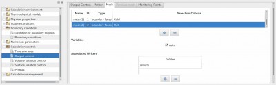

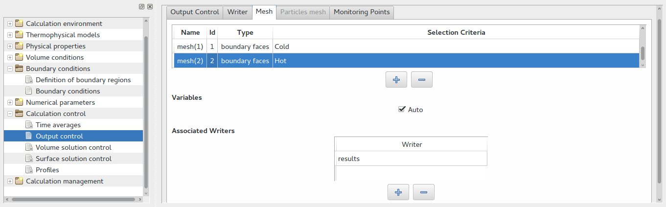

If I'm not misunderstanding your question you can retain the boundaries group through the the GUI of CS. You have to go to the "Mesh" tab In the "Calculation Control" -> "Output Control" section and there you can use the same selection criteria that you use to set up the boundaries condition. In "Type" you have to choose "Boundary faces" and then you have to select the default writer (results) or you can another writer if you want.
I attach a figure where I select the Hot and Cold boundaries of the heat square cavity,
Luciano

Many thanks for your response - unfortunately I don't use the GUI (I should have specified). Ill continue searching for the correct syntax. Many thanks for your help.
