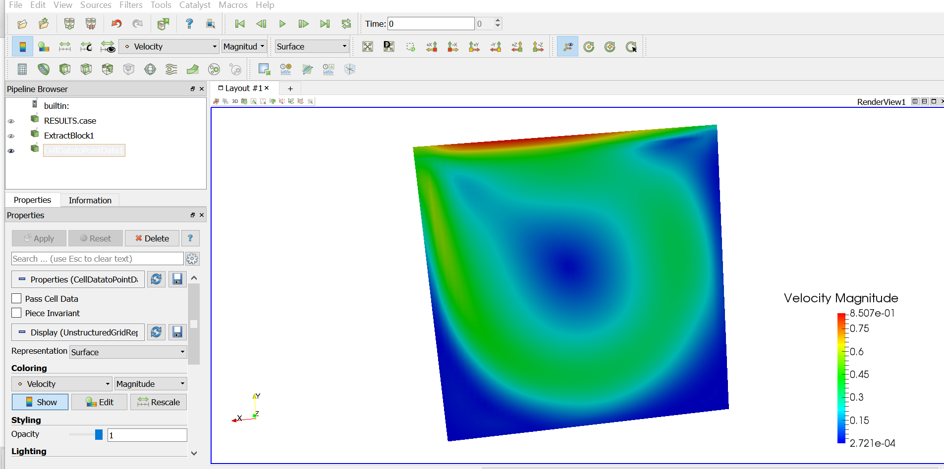

Hello Guys, an update here. Yes I was successful running a case here too, one of the tutorial cases.
Actually the good thing is that I am running Windows 10 64bit as will with Salome 7.6 and Para view for viewing.
Thanks,
