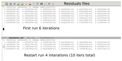

I tried a restart and It may worked but one thing it is not clear: my residual.csv shows the same number of iteration as the first calculation; although the file was written at the end of the restart calcultion.
I did two steady simulation:
1) 10 iteration
2-restart) 15 iterations

It's strange... you should have the number of iterations of each run, like in the following example.
You can force the flush of the listing, residuals ant time_stat using the control_file, check the user guide there is info about the use of the control_file.
