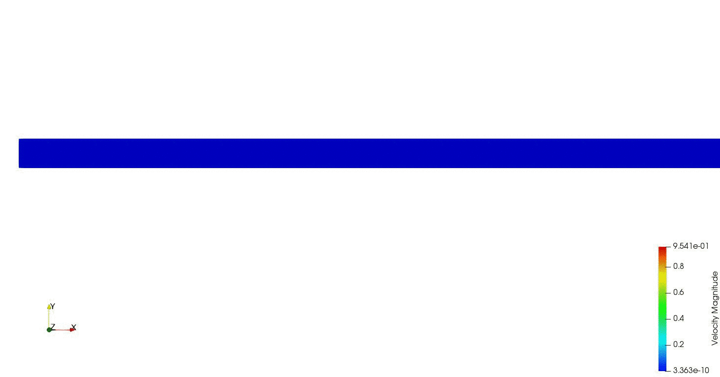

I would like to know how to impose a sliding mesh with a free inlet/oulet boundary conditions.
When I use symmetry boundary condition for the INLET (ENTREE) and the OULET(SORTIE), the simulation run but the velocity field is not correct (attached picture).
Is it possible to impose a sliding mesh with a free inlet/outlet?

Hello Djeen,
You are right, if you set free inlet / outlet no option for ALE BC appears. When I tested your case I change the free inlet / outlet to one inlet and one outlet in order run a more "classical" problem, I found the problem in the mesh so I set sliding mesh for the inlet and outlet and everything works fine. Then I changed the inlet and outlet to a free inlet / outlet and the ALE Bc remain in a sliding condition.
So, I guess that in can be a bug in the GUI, because when you set free inlet / outlet no option for ALE BC appears.
Follow the steps that I mention and check the xml file for the ALE BC
