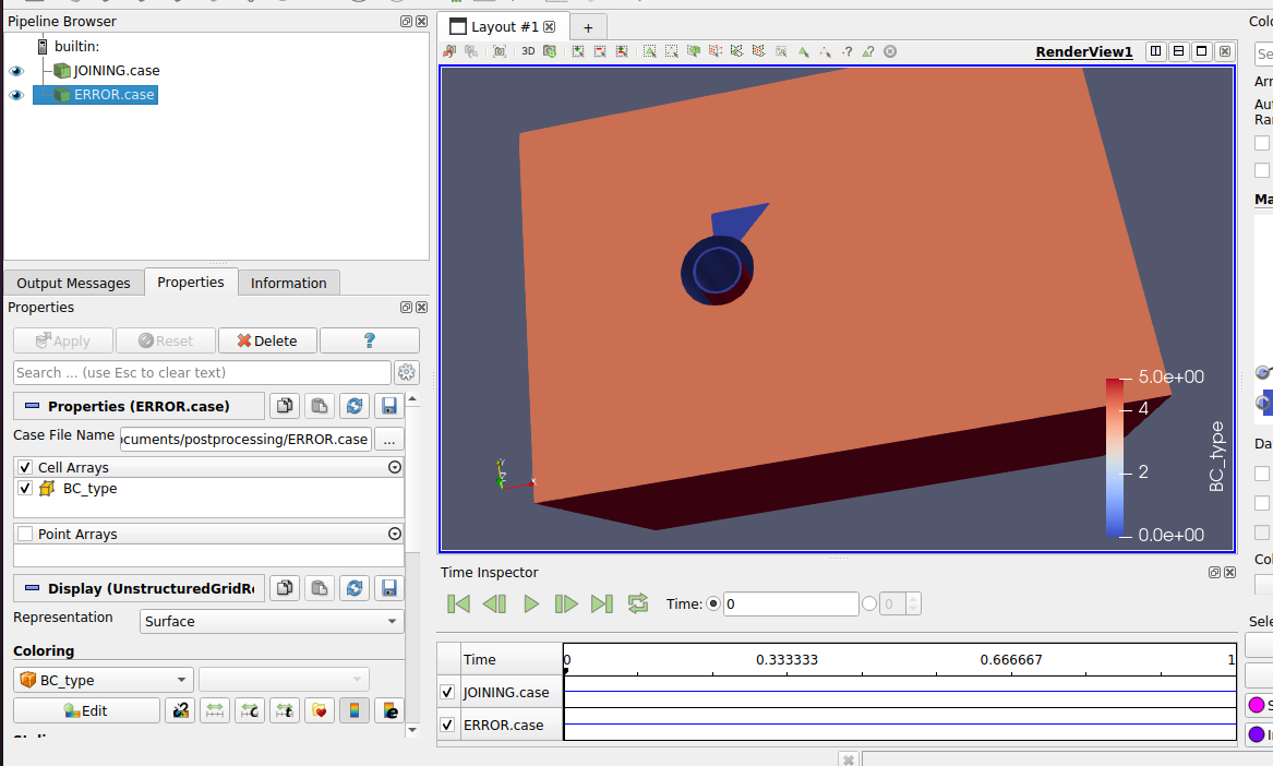

when i'm launching the study i obtain the error message :
First face with boundary condition definition error
(out of 22050)
has boundary condition type 0, center (-0.000785039, -0.0299794, 0.00983333)
(out of 22050)

Did you visualize the error location as recommended in the error message ?
Re: sewing two meshes
I find it difficult to understand the error message and treat it. I have opened the error case in paraview but i don't know how to fix the error

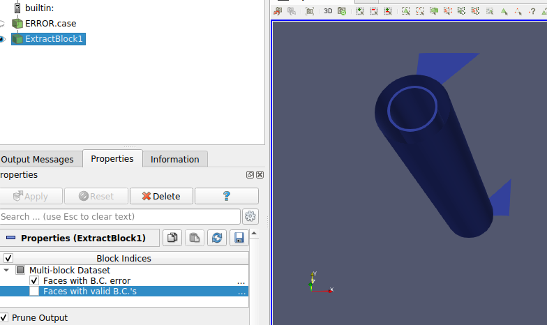

You need to use the "extract blocks" filter to see which faces have Ok boundary conditions and which ones have errors.
Of course, if you simply use the "Mesh preprocessing mode of code_saturne to check boundary group locations (also requiring "extract blocks" if you are using EnSight format, you can probably see where you have an issue before that.

Thanks yvan for tour quick feed back : the errors relates to the two faces that i like to join : Groupe_1 and surfext :
I'll try to understand why such default and have rebuilt the meshes but it still not working
May be groupe_1 and surfext are too far from each others (indeed i don't have use right diameter concerning the cylinder hole, it should be equal to the most important node deplacement of " masolide" structure) but assuming that for instance,, i'm just trying to test the process i don't understand the case errors

You probably have a mesh joining issue, which might be solved by setting different parameters (if your meshes are not too far apart).
