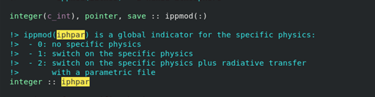

To check why the relaxation coefficient was not written in V7, I found it is suspicious in the following part, the relaxation coefficient will be output on condition ippmod(iphpar).ge.2 as I highlight in the snippet 1 (/base/impini.f90). However, as you can see from snippet 2(/pprt/ppincl.f90), it can only be switched on for the specific physics plus radiative transfer problems.
