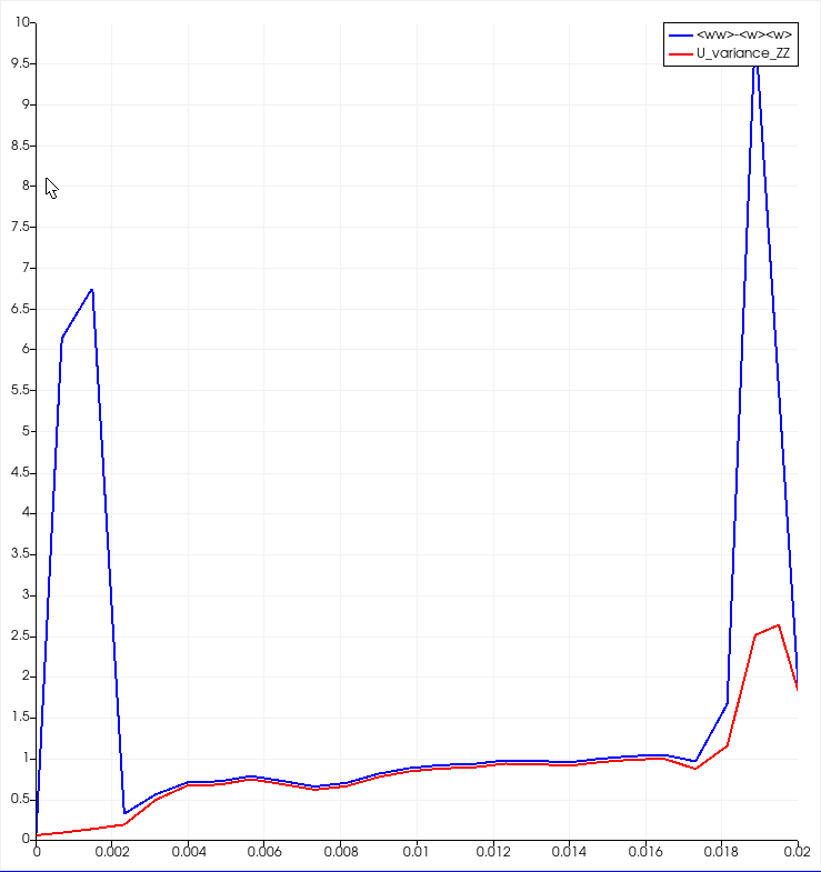

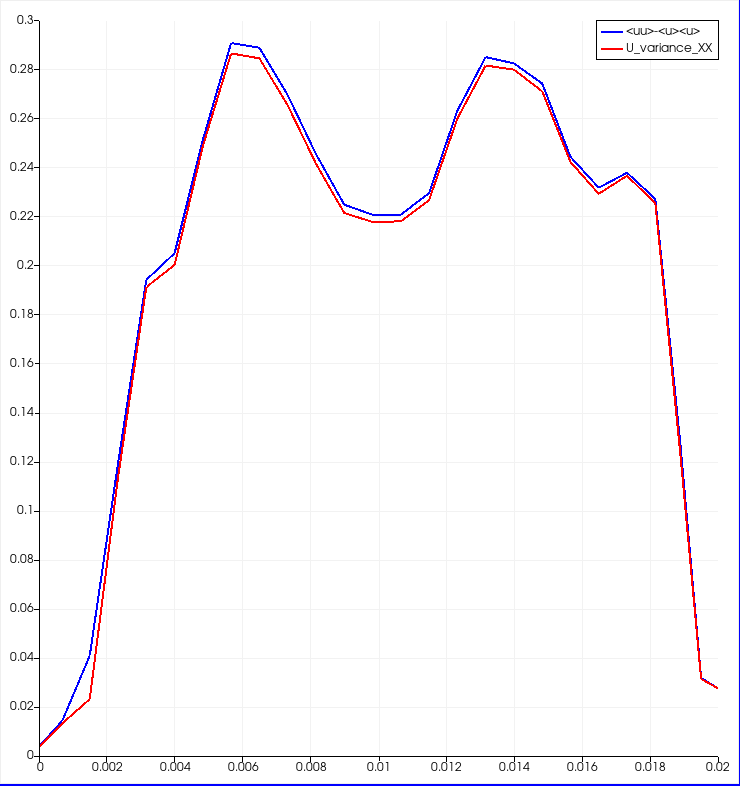

Please I also have a question about variance. Following the Time moment related options-Example 1 (https://www.code-saturne.org/cms/sites/ ... eters.html), I calculated the variance of the vector velocity, and got a tensor of 6 components.
In the codes comments, I learned the velocity variance is <UU>-<U><U>. If we define u, v, w as the 3 components for velocity. I checked the results, the XX component of velocity variance is exactly <uu>-<u><u>. But the YY and ZZ components seem not consistent with <vv>-<v><v> and <ww>-<w><w> respectively. Please see the figures below.
So I'm also confused about how the variance is calculated. Also I'm not able to find a detailed description of the function CS_TIME_MOMENT_VARIANCE used in the codes. If some experts can guide me, it will be much appreciated.

These are 2 different notions :
- a variable's variance is a solved variable, sharing a base variable's boundary conditions, and for which an transport equation is solved. There are a few details (not much) in the user or theory documentation, but I am not too familiar with this part of the code. To the best of my knowledge, this is related a a variable's turbulent fluctuations.
- a variance computed as a time moment is simply the variance (in the statistical sense) of a field's values at each selected location in space (usually cell centers). It can be computed using recursive formulas, as described in the article by Pébay you will find in the code's bibliography. Search for the cs_time_moment.c file in the Doxygen documentation for more details.
