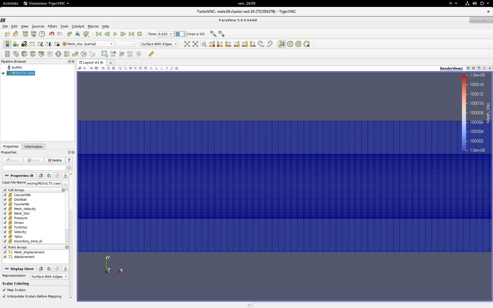

I am dealing with a case consisting in simulating a flow between two moving plates. The movement of these plates is imposed. The problem is that the internal mesh don't follow the plate displacement, even when I use a big mesh viscosity (see joined picture). I'll like to know how to impose mesh displacement with Code_Saturne 5.0.

What does the mesh displacement visualization look like ? Your figure does not show the deformation field, only the viscosity. I recommend also using the extract block filter (or separate meshes writer option in Code_Saturne) to separate boundary and volume meshes in ParaView.

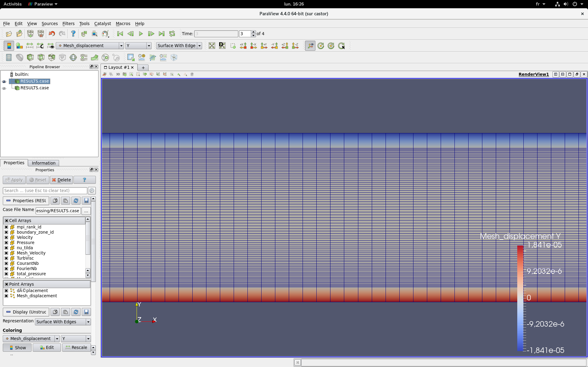

Please find attach the mesh displacement visualization and the runcase. The separate meshes writer in Code_Saturne doesn't anything.

The fact that the boundary cells are much wider than the following cells probably leads to very small deformation inside the mesh. Uding a more regular mesh will provide better résults in most cases.
