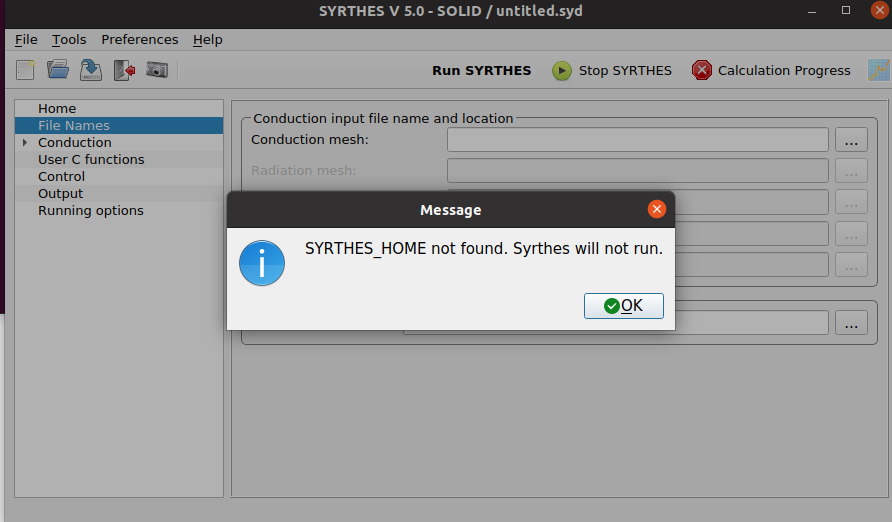

Then, launching the syrthes_install.py program leads to errors explained in the syrthesconvert.log (attached), but it seems to be ok so I finally decided to launch the GUI anyway, and to test the 3D_2D_DISKS tutorial. At the step of adding the mesh, the following error appears:
I have obviously sourced syrthes with xx/bin/syrthes.profile just before, so the env variable SYRTHES_HOME is /home/sim/syrthes/syrthes5.0/arch/Linux_x86_64
I suspect a problem with my gcc version (which is 4.9)... Is syrthes 5 compatible with Ubuntu20 ?
