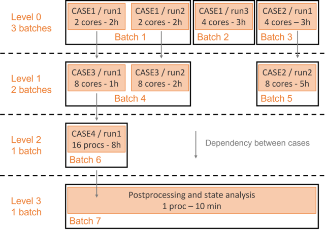

In the following example, a list of 8 cases is launched in SLURM batch mode:
$ code_saturne smgr --submit -rp --slurm-batch-size=2 --slurm-batch-wtime=5
Exemple of cases allocation per batch
Here are some explanations on cases allocation per batch :
  • In level 0, batch 1 is limited by the number of cases with the same number of processes. Batch 2 is limited to one case (CASE1/run3) as the maximum time in this batch would have exceeded 5 hours including the next case (CASE2/run1). Batch 3 only includes the last case at level 0.
  • In level 1, batch 4 is limited by the maximum number of cases per batch (2). Batch 5 only includes the last case at level 1. Batche 4 depends on batch 1 and batch 5 depends on batch 3.
  • In level 2, batch 6 only includes the last case of the level. It depends on batch 6.
  • In level 3, batch 7 includes postprocessing and state analysis. The final batch depends on all cases from all steps.
