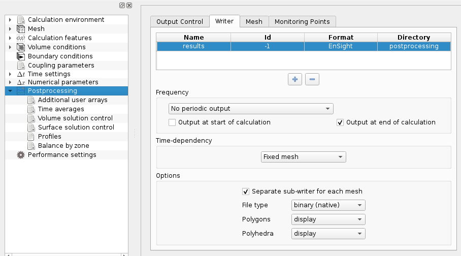

Using the GUI, writers can be managed and defined in the following page:

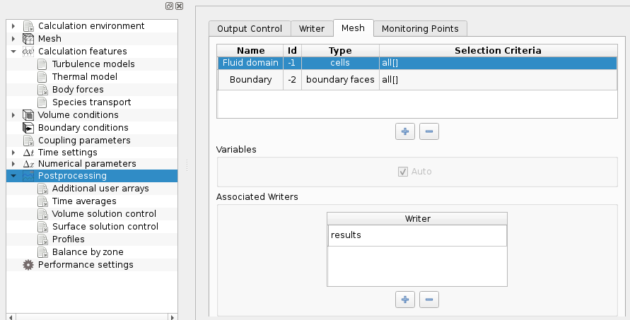

And postprocessing meshes can be handled in the following tab:
In order to allow the user to add an output format to the main output format, or to add a mesh to the default output, the lists of standard and user meshes and writers are not separated. Negative numbers are reserved for the non-user items. For instance, the mesh numbers -1 (CS_POST_MESH_VOLUME) and -2 (CS_POST_MESH_BOUNDARY) correspond respectively to the global mesh and to boundary faces, generated by default, and the writer -1 (CS_POST_WRITER_DEFAULT) corresponds to the default post-processing writer.
The user chooses the numbers corresponding to the post-processing meshes and writers he wants to create. These numbers must be positive integers. It is for example possible to associate a user mesh with the default post-processing writer (-1), or to add outputs regarding the boundary faces (-2) associated with a user writer.
For safety, the output frequency and the possibility to modify the post-processing meshes are associated with the writers rather than with the meshes. This logic avoids unwanted generation of inconsistent post-processing outputs. For instance, ParaView or EnSight would not be able to correctly read a case in which one field is output to a given part every 10 time steps, while another field is output to the same part every 200 time steps. If some fields should be output using different frequencies, using separate writers allow maintaining consistent output sets.
To prevent output related to a given mesh (including the default), the list of associated writers should be made empty.
Note that the default writer and meshes cannot be "undefined", though they may be renamed and their settings modified. A writer with no associated mesh is inactive, so removing the default writer from the list of writers associated to all meshes deactivates the default output.

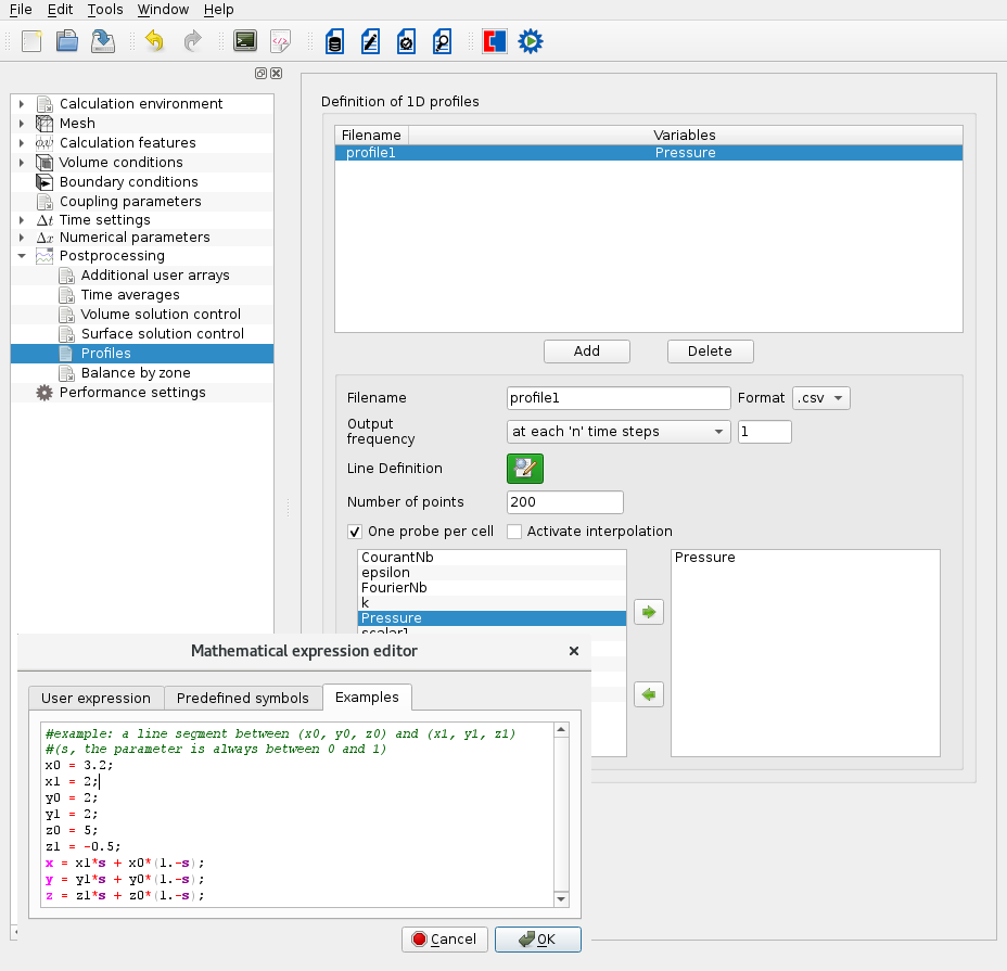

Profiles are defined as a special type of probe set, for which a curvilinear coordinate (the local profile coordinate) is defined, and are typically used not with time plots, but with simple plots (also in CSV or text format) where one file is associated to a single time step, and columns correspond to different variables, and lines to different positions along the profile.

Profiles are also handled in a specific manner, as they are automatically associated with default simple plot writers (CSV or text), and the associated variables may be selected specifically.
This presentation difference is mainly due to historic reasons (it predates the unification of probes, profiles, and other writers), not to a difference in the concepts used (so the logic may seem more consistent with user-defined functions).

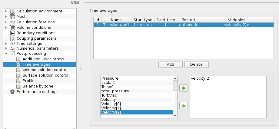

In code_saturne, it is possible to define time moments for existing variables (fields) or user-defined formulas, including both means and variances. This is limited to visualization output, so for example although the variance of a vector (which is a tensor due to the covariance terms) may be computed, the variance of a tensor may not (though that of specific components may always be computed).
This computation uses recurrence formulas, so at any given time steps, the mean or variance field values are always updated and accessible as a regular field. The computation of time moments may start at a user-defined time step of physical time so as not to include transient initialization data. In this case, the associated field values before actually starting the moment updates is 0.
Time moments may be defined in the GUI, as shown below, or using the cs_user_time_moments function in cs_user_parameters.c (see Time moment related options examples).

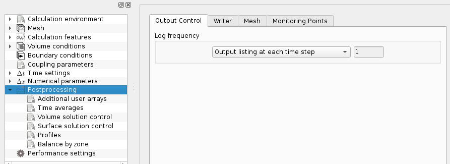

The logging output frequency may be managed using the GUI, as shown below. The first 10 time steps are always logged. When running many time steps, it recommended to use a logging period greater than 1 (20 or 100 are often sufficient), as logging each time step with even a moderate verbosity can lead to large run_solver.log files.
Note that logging verbosity is also influenced by the verbosity used for solved variables.
