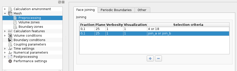

Mesh joining
Conforming joining of possibly non-conforming meshes may be done by the solver, and defined either using the Graphical User Interface (GUI) or the cs_user_join user function. In the GUI, the user must add entries in the "Face joining" tab in the "Mesh/Proprocessing" page. The user may specify faces to be joined, and can also modify basic joining parameters.
Defining a mesh joining
For a simple mesh, it is rarely useful to specify strict face selection criteria, as joining is sufficiently automated to detect which faces may actually be joined. For a more complex mesh, or a mesh with thin walls which we want to avoid transforming into interior faces, it is recommended to filter boundary faces that may be joined by using face selection criteria. This has the additional advantage of reducing the number of faces to test for in the intersection/overlap search, and thus improving the performance of the joining algorithm.
One may also modify tolerance criteria using 2 options, explained in the figure below:
  • fraction assigns value $r$ (where $0 < r < 0.49$) to the maximum intersection distance multiplier ( $0.1$ by default). The maximum intersection distance for a given vertex is based on the length of the shortest incident edge, multiplied by r. The maximum intersection at a given point along an edge is interpolated from that at its vertices, as shown on the left of the figure
  • plane assigns the maximum angle between normals for two faces to be considered coplanar ( $25^{\circ}$ by default); this parameter is used in the second stage of the algorithm, to reconstruct conforming faces, as shown on the right of figure
Maximum intersection tolerance and faces normal angle
As shown above, verbosity and visualization levels can also be set, to obtain more detailed logging of the joining operations, as well as detailed visualizable output of the selected and joined faces.
In practice, we are sometimes led to increase the maximum intersection distance multiplier to 0.2 or even 0.3 when joining curved surfaces, so that all intersection are detected. As this influences merging of vertices and thus simplification of reconstructed faces, but also deformation of "lateral" faces, it is recommended only to modify it if necessary. As for the plane parameter, its use has only been necessary on a few meshes up to now, to reduce the tolerance so that face reconstruction does not try to generate faces from initial faces on different surfaces.
This operation can be specified either using the GUI or the user-defined functions, as shown in various examples.

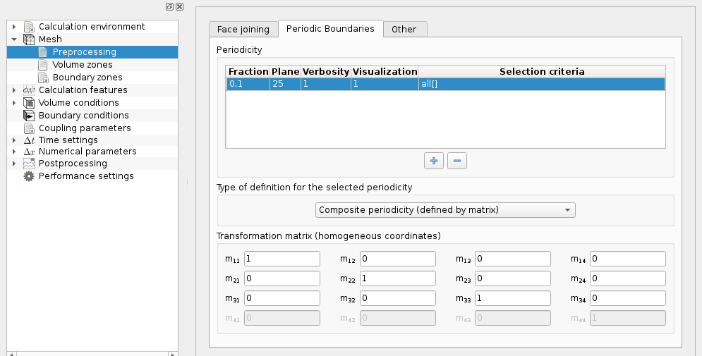

Periodicity
Handling of periodicity is based on an extension of conforming joining, as shown on the following figure. It is thus not necessary for the periodic faces to be conforming (though it usually leads to better mesh quality). All options relative to conforming joining of non-conforming faces also apply to periodicity. Note also that once pre-processed, 2 periodic faces have the same orientation (possibly adjusted by periodicity of rotation).
Matching of periodic faces: base principle
As with joining, it is recommended to filter boundary faces to process using a selection criterion. As many periodicities may be built as desired, as long as boundary faces are present. Once a periodicity is handled, faces having periodic matches do not appear as boundary faces, but as interior faces, and are thus not available anymore for other periodicities. Translation, rotation, and mixed periodicities can be defined.
This operation can be specified either using the GUI, as shown below, or by user-defined functions, as shown in various examples.
Defining a periodicity relation
