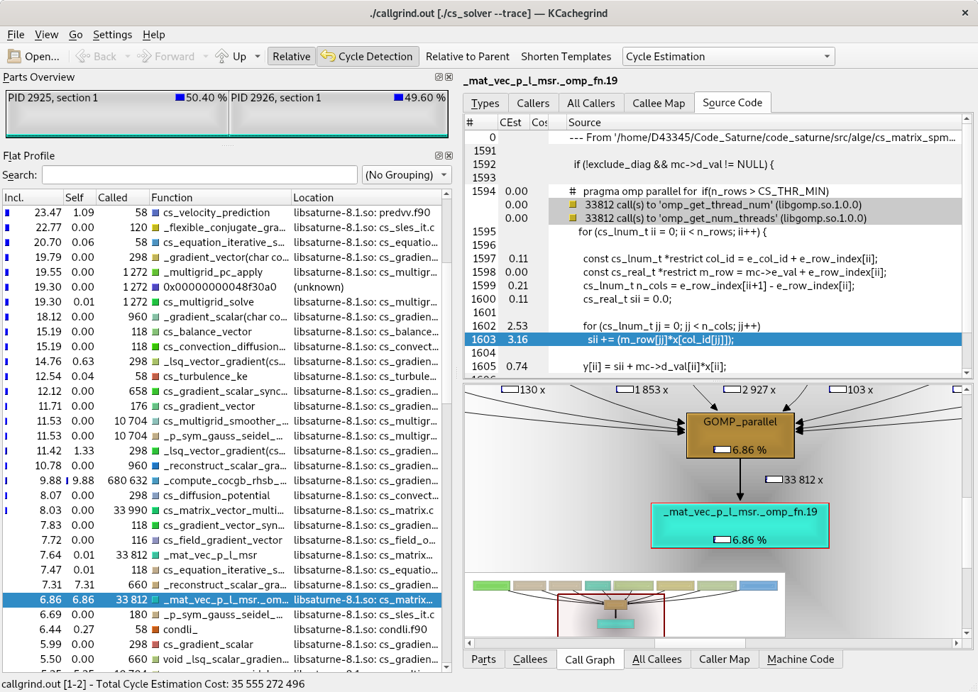

    • Callgrind functions as a "general purpose" profiler, and can be used in a similar manner, using
      valgrind --tool=callgrind
    Combined with the kcachegrind visualization tool, it is extremely easy to use on a Linux workstation. It allows easy visualization of call trees and hot spots, as illustrated below:

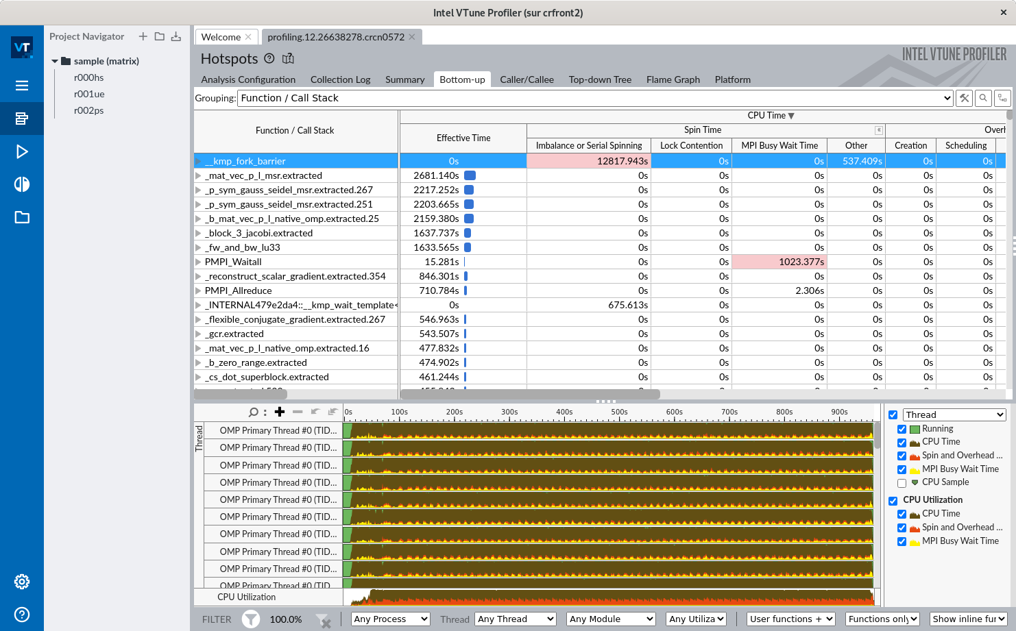

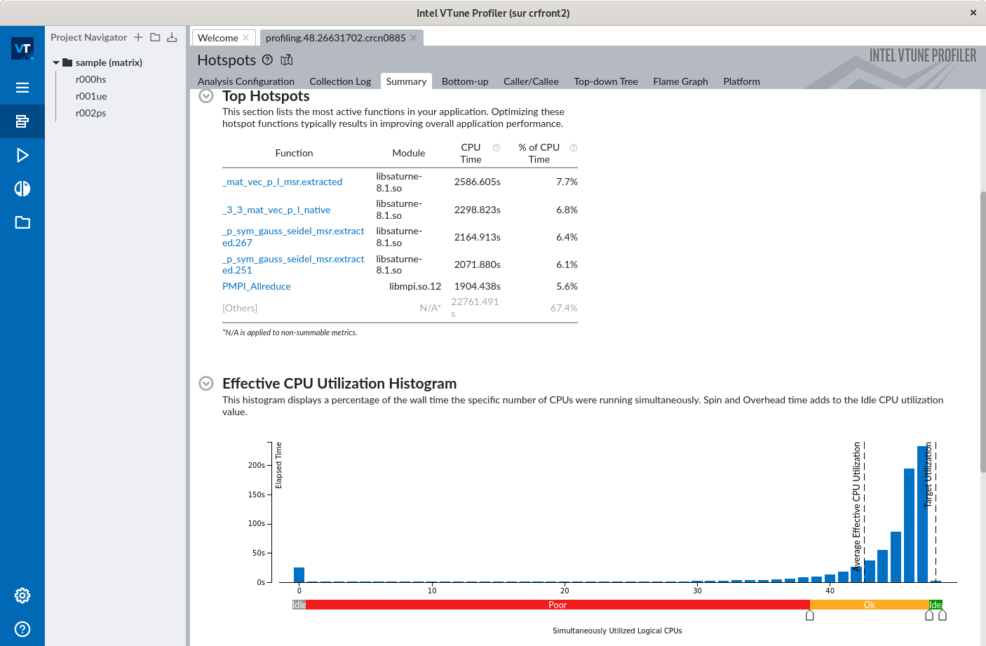

VTune allows many exploration views, for example:
VTune summary page
or
VTune hotspots view
