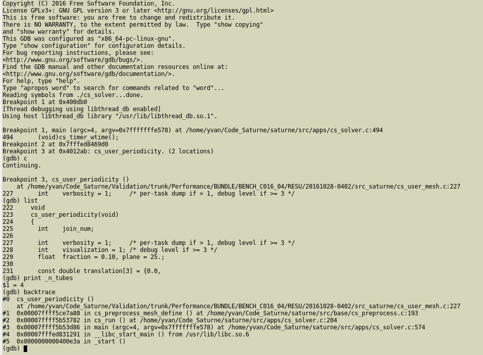

The GNU debugger
The GNU debugger https://www.gnu.org/software/gdb is a broadly available, interactive debugger for compiled languages including C, C++, and Fortran.
  • To debug an executable, run gdb <executable>
    • Under the gdb prompt, type help for built-in help, q to quit.
    • Help is grouped in categories
      • The most common options are:
        • b (set breakpoint),
        • c (continue to next statement),
        • s (step into function),
        • p (print).
    • Many front-ends are available, including:
  • GDB can provide some information on any compiled program, but provides more detailed and useful information when the program was compiled with debugging info. The matching compiler option is usually -g, and in the case of code_saturne, is provided using the --enable-debug configure option at installation.
GDB basic interface
When used directly, GDB runs in a single terminal frame, as shown here. Only the current line of code is shown, though the list command allows showing more.
GDB in terminal mode

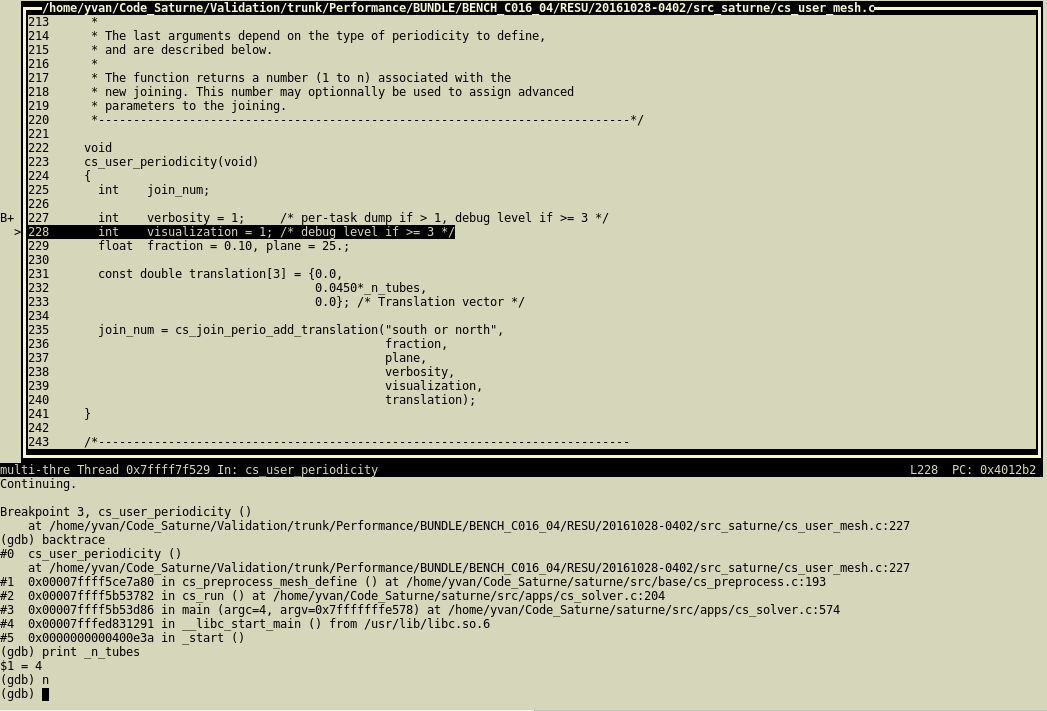

When started with the -tui option, GDB runs in a split terminal, with source on top, commands on bottom.
  • Using the CTRL+x+o key combination allows changing focus from one to the other.
  • Using the CTRL+l key allows refreshing the display.
GDB with split screen

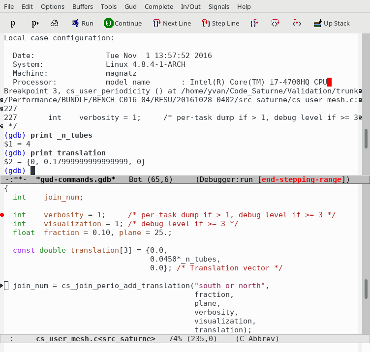

GDB may also be run under Emacs, which provides syntax highlighting of source code.
GDB under Emacs

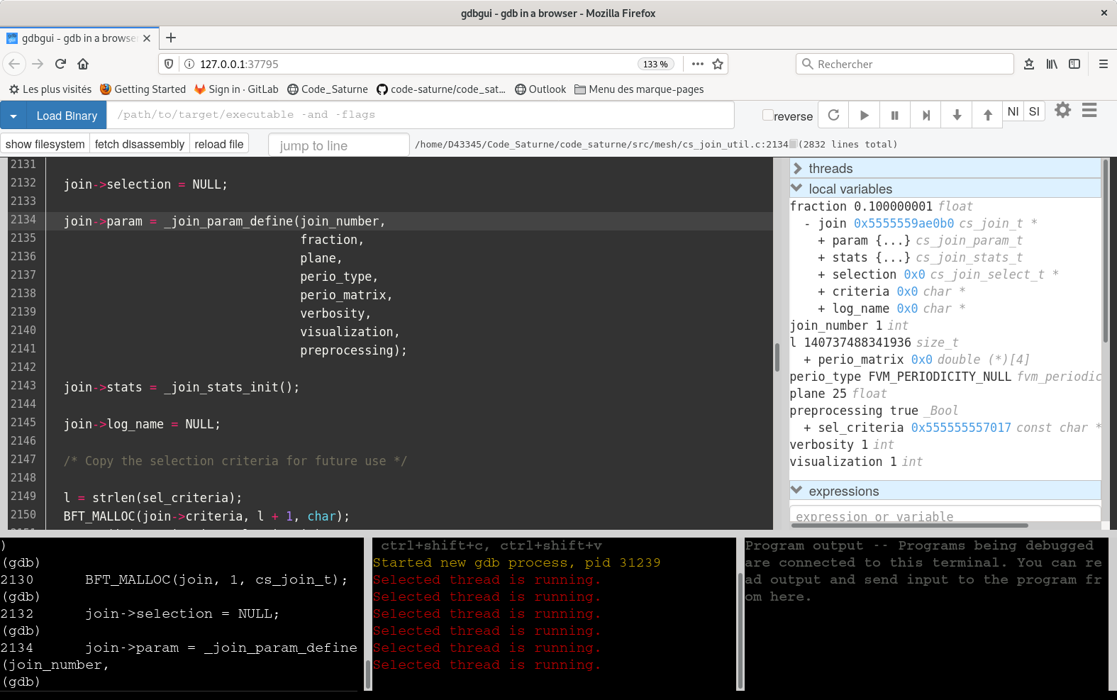

The gdbgui debugger seems promising, and a good potential successor to DDD. It is based on a web-browser interface,
gdbgui

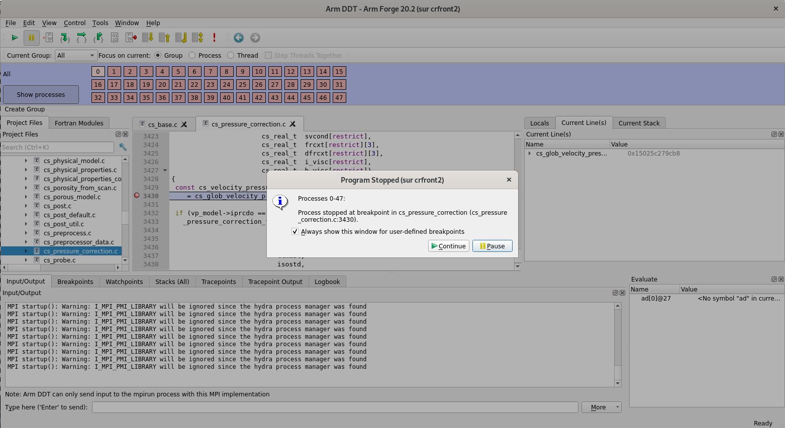

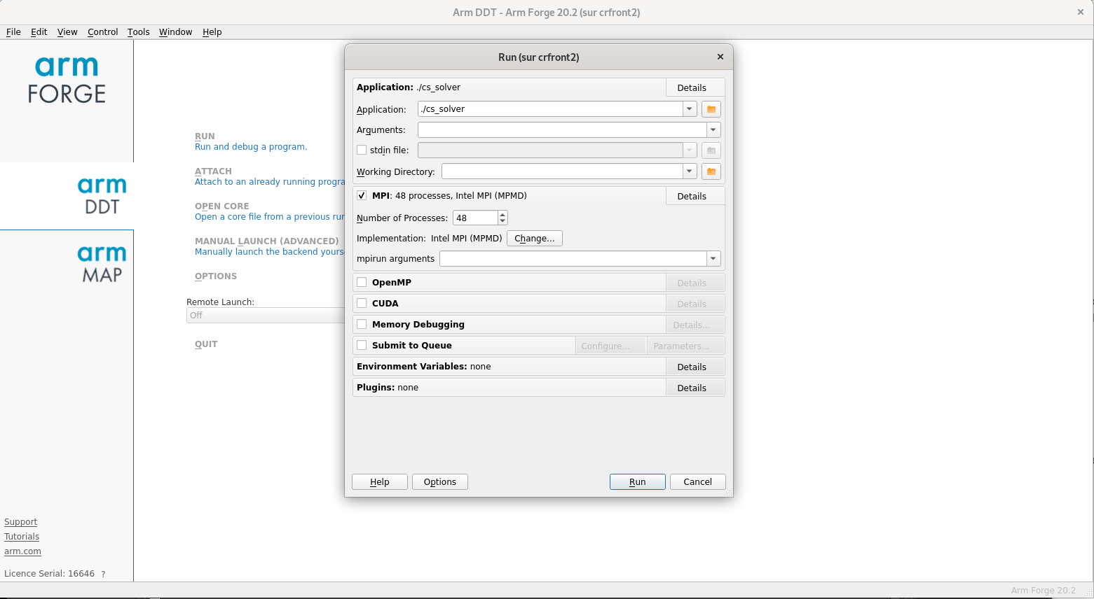

Full integrated development environments (including Qt Creator, Visual Studio Code, Eclipse, Kdevelop, Anjuta) are outside the scope of this documentation. Most members of the code_saturne development team mostly use lighter, less integrated tools, so will not be able to provide recommendations regarding their use.
GDB alternatives
The Eclipse CDT and Eclipse PTP (Parallel Tools Platform) environments integrate debuggers, including a parallel debugger, but may use a different syntax than "standalone" GDB, so they are not considered here (though feedback and recommendations around these tools are welcome).
The LLDB debugger is an interesting competitor to GDB, with a different (similar but more verbose) syntax. Is is not as widely available yet, and is not yet handled by the code_saturne debug scripts, though a user familiar with it could of course set it up.

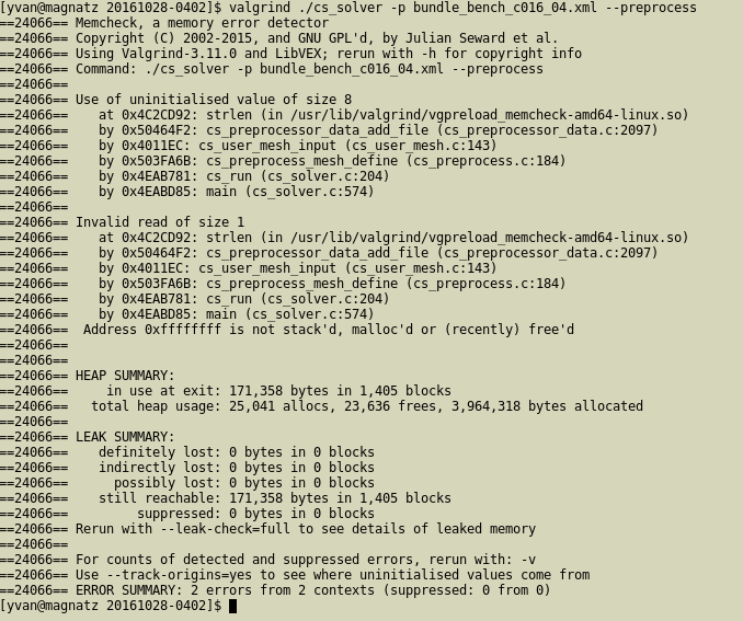

The Valgrind tool suite
The Valgrind tool suite allows the detection of many memory management (and other) bugs.
  • Dynamic instrumentation
    • No need for recompilation
      • Usable with any binary, but provides more info (i.e. code line numbers) with code compiled in debug mode
      • Depending on tool used, run time and memory overhead from 10-100x.
        • With default tool (Memcheck), 10x30.
        • Use proactively, to detect bugs on small cases, before they become a problem in production cases.
Valgrind is easy to run:
  • Prefix a standard command with valgrind
    • By default, uses the memcheck tool.
    • Tool may be changed using valgrind –tool=/cachegrind/callgrind/drd/massif/...
  • Valgrind may be combined with GDB using its gdbserver mode.
    • To use this mode, call valgrind –vgdb-error=<number>
      • The number represents the number of errors after which the gdbserver is invoked (0 to start immediately).
Valgrind in a terminal

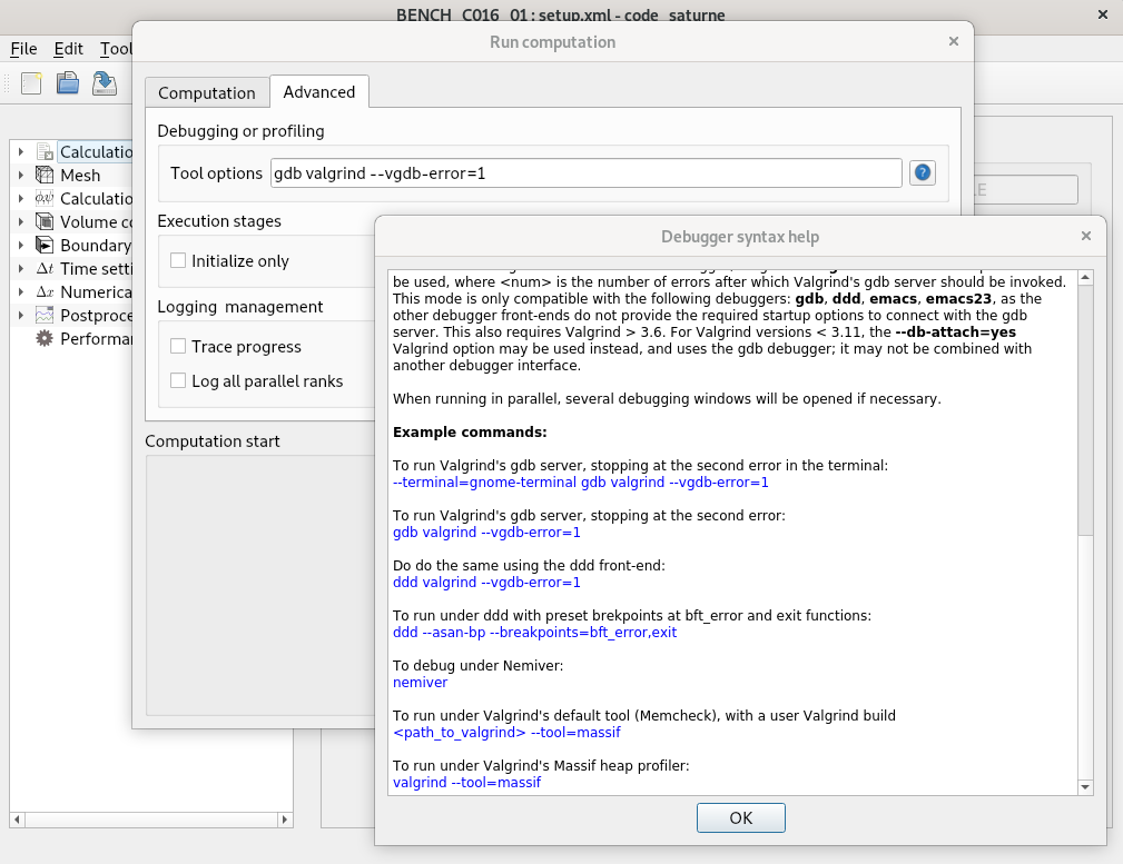

Starting the code_saturne solver under a debugger
Several ways of setting code_saturne to run under a debugger are possible:
  • Using the GUI, set options in Run computation/Advanced options`
    • The associated help provides several examples
    • This sets a debug_args option under the current resources section in the case's run.cfg file, which can also be edited directly.
  • The same options can be provided directly to code_saturne run using the --debug-args option
Example of use of debugger wrapper
When the code is run, the debugger will then be launched automatically.

Example commands:
To simply run using the gdb debugger:
gdb
To run Valgrind's gdb server, stopping at the second error in the terminal:
--terminal=gnome-terminal gdb valgrind --vgdb-error=1
To run Valgrind's gdb server, stopping at the second error:
Do do the same using the ddd front-end:
ddd valgrind --vgdb-error=1

Using a parallel debugger
If a true parallel debugger such as TotalView or Arm is available, the following procedure may be used:
  • First, initialize the execution directory, using one of the following methods:
    • From the GUI, in the advanced run/job submission options, check "initialize only", then submit the computation.
    • Outside the GUI, run code_saturne submit --initialize In either case, the code will prepare the execution directory, and preprocess the mesh if needed, but not remove the executable and temporary script.:
  • Once the stage has finished, cd to the execution directory, and edit the run_solver script script:
    • Add commands necessary to load the debugger's environment. For example, on the EDF Cronos cluster, this requires adding
      module load arm-forge
      in the section where other modules are added.
    • Search for the line actually launching the solver, near the end of the script; before the cs_solver command, insert the debugger command. For example, for the DDT debugger, replace
      mpiexec <options> ./cs_solver
      with:
      mpiexec ddt <options> ./cs_solver
  • If using a batch system, request an interactive allocation (for example, using salloc with SLURM). ** This step is important: without this, you may be trying to run a large job on a front-end node, and your cluster administrators will not be happy.**
  • You can then run:
    ./run_solver
    which will launch the code under the interactive debugger.
Debuggers such as DDT allows to easily switch between global and local stepping through the program and exploring its data, using a single window, as illustrated in this screenshot:

  • In case launching the debugger fails, an alternative option is to simply replace the whole launch command (the line containing cs_solver) with the command launching the debugger's GUI, for example
    ddt
    And then simply follow the debugger prompts for command launch options, as shown in the example below.
    Example DDT launch options
