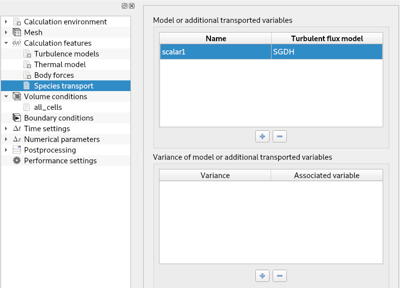

The source terms in the transport equations related to the user scalars (passive or not, average of the square of the fluctuations of a scalar, ...) can be filled in thanks to the GUI or the cs_user_source_terms user file. Without the GUI, the cs_user_source_terms function is used to add source terms to the transport equations related to the user scalars, this function is called every time step, once for each user scalar. The user must provide the arrays st_imp and st_exp related to each scalar. st_imp and st_exp must be set to 0 for the scalars on which it is not wished for the user source term to be applied.

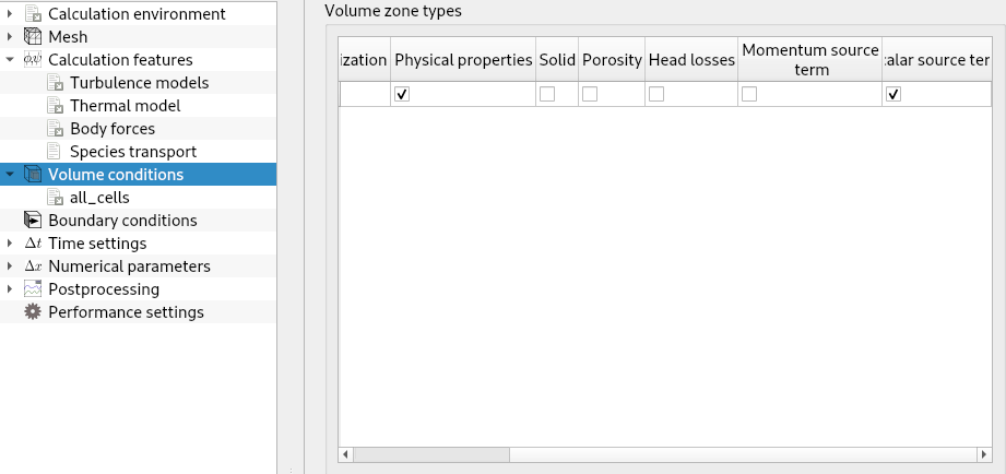

The GUI can be used if the source terms are proportional to the volume of the cells or the volume of the fluid in the cell.

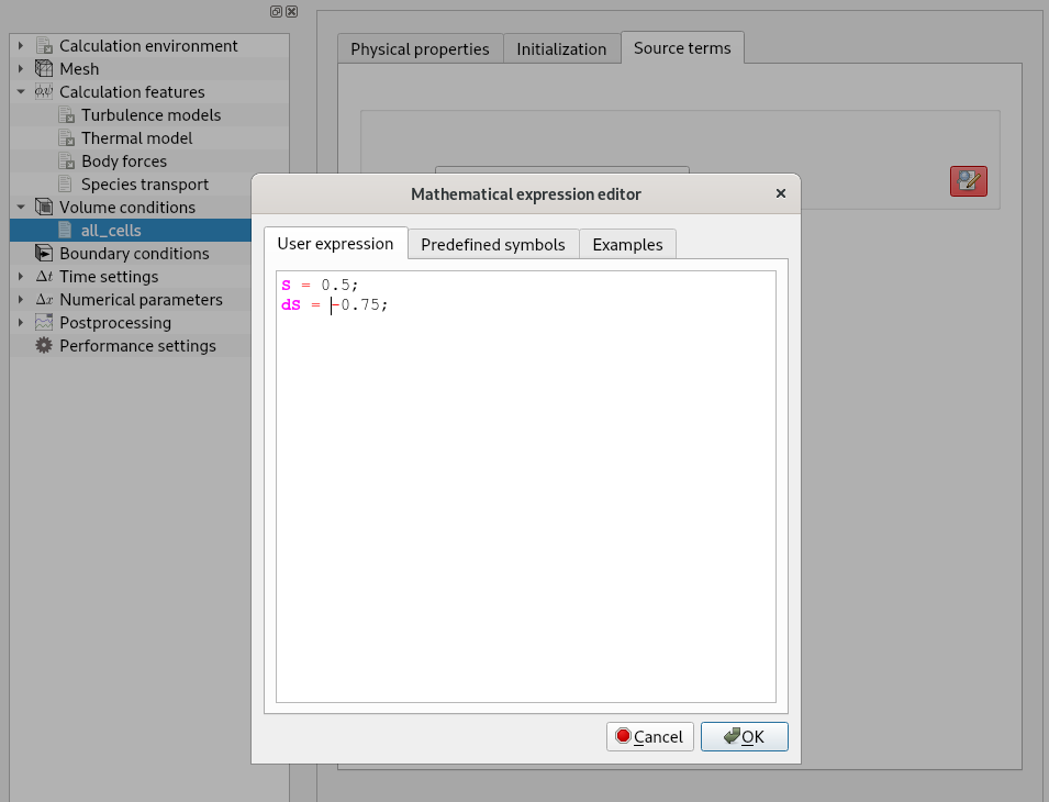

By example if we have:
![$\text{\texttt{st\_exp[c\_id]}}= 0.5*\text{\texttt{cell\_vol[c\_id]}}$](form_895.png)
![$\text{\texttt{st\_imp[c\_id]}}= -0.75*\text{\texttt{cell\_vol[c\_id]}}$](form_896.png)
We can define them directly in the GUI
