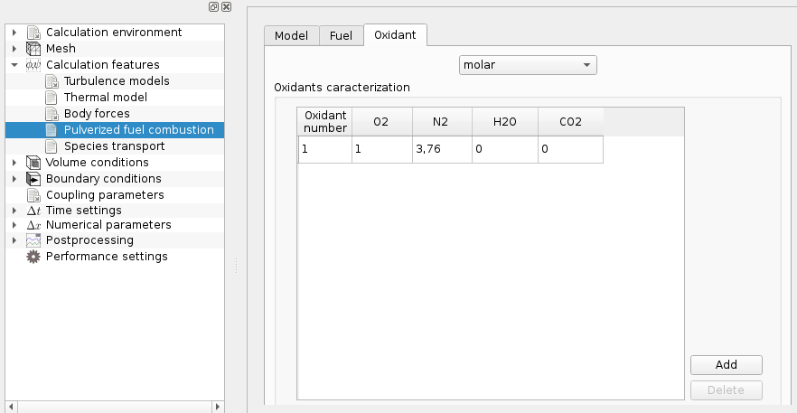

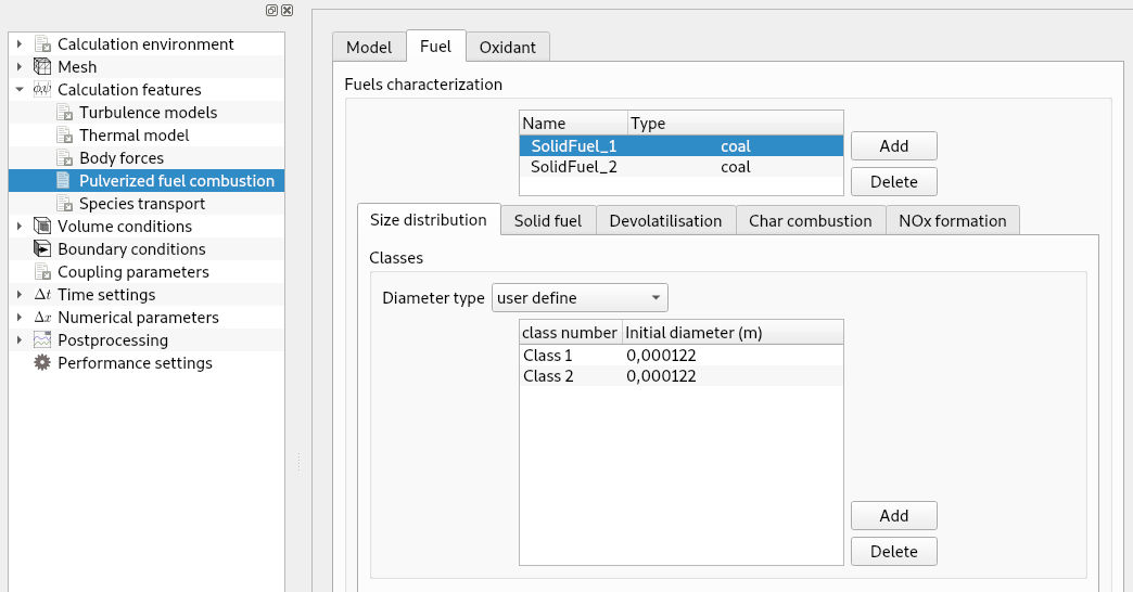

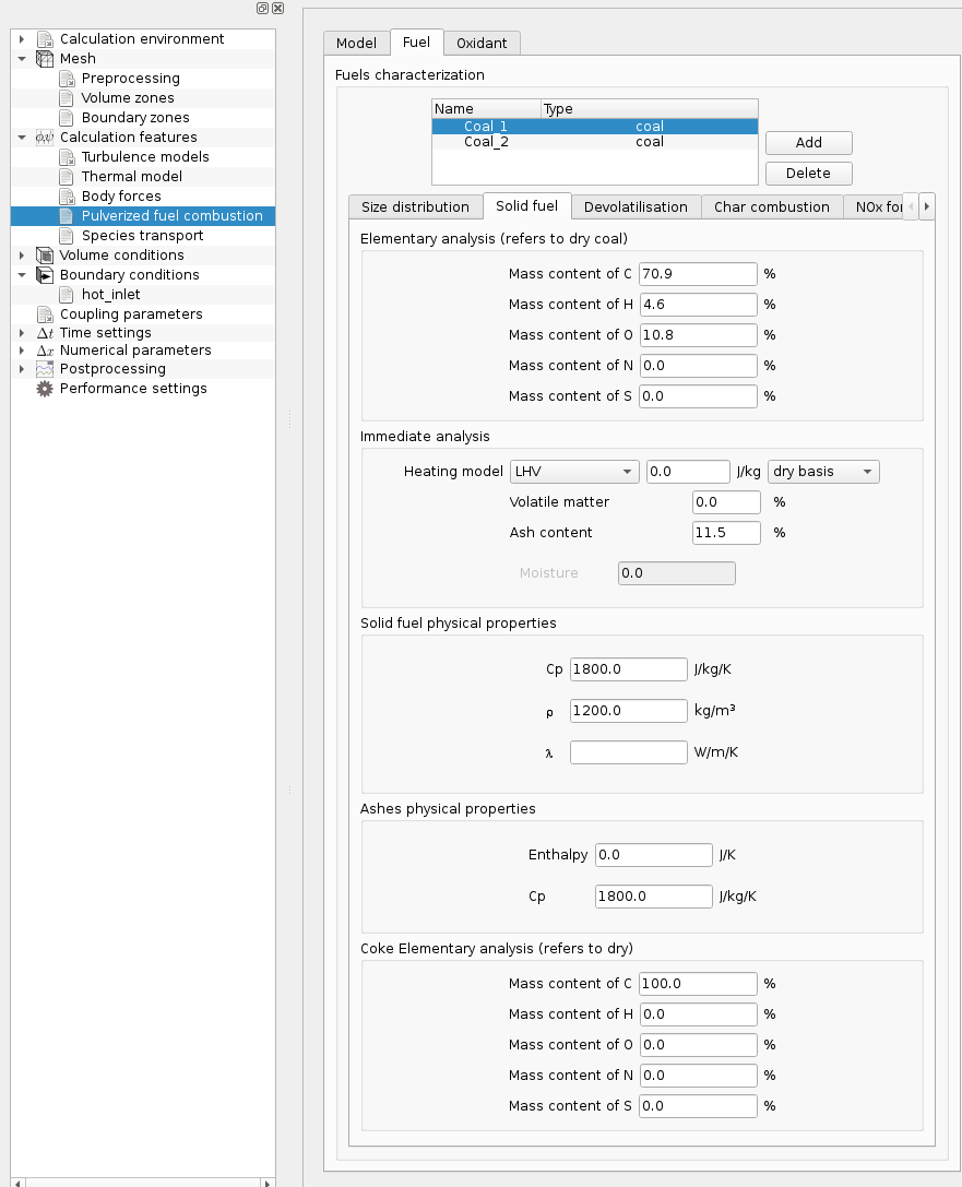

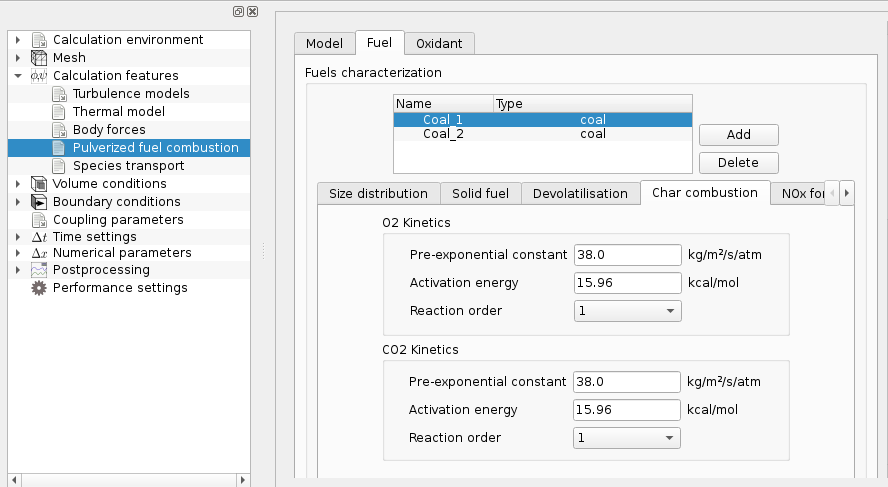

In the GUI, when a Reactive flows (combustion) is selected in the item “Calculation features”, an additional item appears: “Gas combustion” the user can change it by “Pulverized coal”. In this item the user can define coal types, their composition, the oxidant and reactions parameters, see the following figure.
Thermophysical models - Pulverized coal, coal model
Thermophysical models - Pulverized coal, coal classes
Pulverized coal combustion, coal composition
Pulverized coal combustion, reaction parameters
Pulverized coal combustion, oxydant

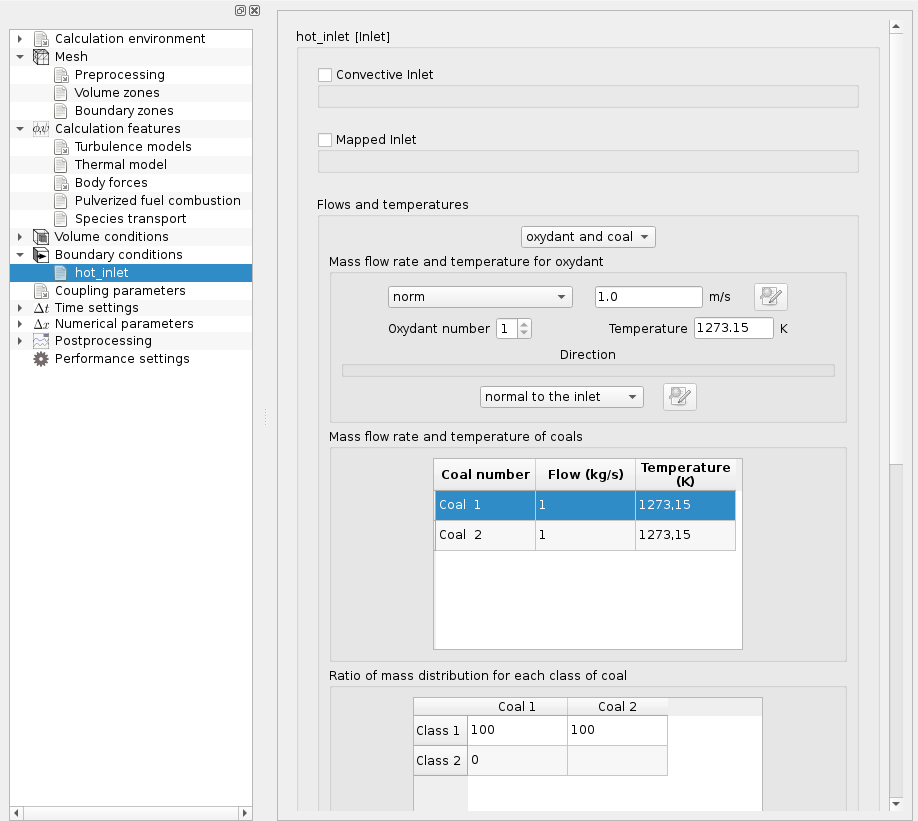

For pulverized coal, it is possible to manage the boundary conditions in the Graphical User Interface (GUI). When the boundary zones is actived, the user specific boundary conditions are activated for inlets
Boundary conditions for the pulverized coal module

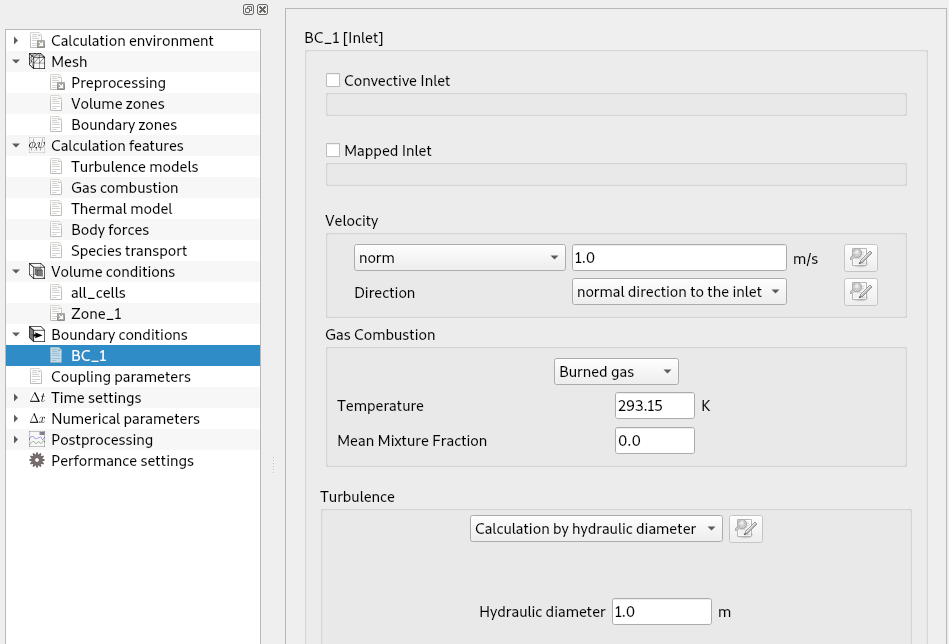

For gas combustion it is also possible to manage the boundary conditions for the inlet in the Graphical User Interface (GUI). The user can choose between the burned gas or the Unburned gas, impose the the mass flow and velocity
Boundary conditions for gas combustion

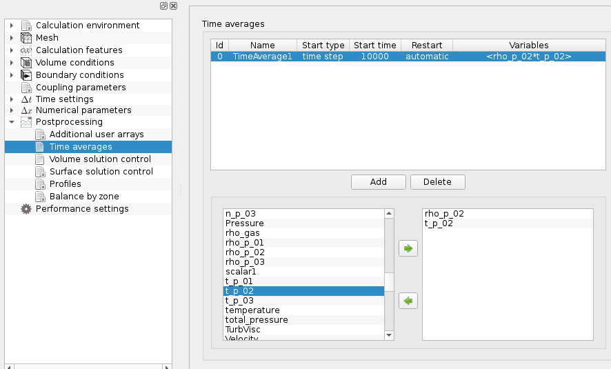

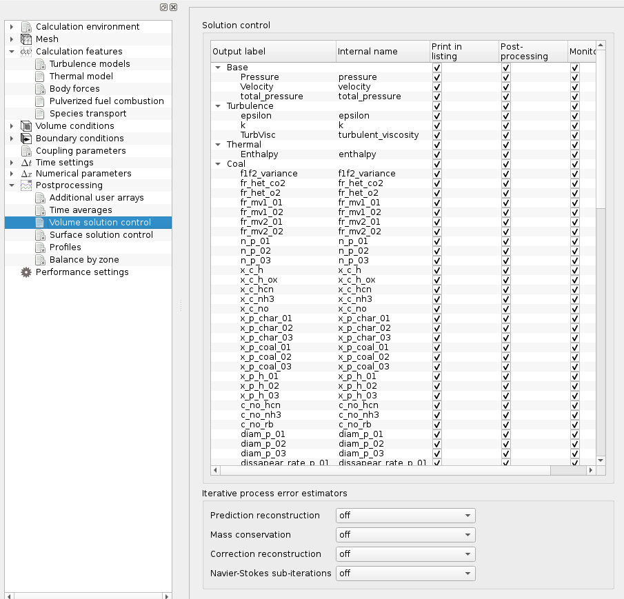

In the case of gas combustion or pulverized coal combustion, time averages, chronological records and log follow-ups can be set in GUI or in the cs_user_parameters function. In the GUI, under the heading Calculation control, additional variables appear in the list in the items Time averages and Profiles, as well as in the item Volume solution control
Calculation control - Time averages
Calculation control - Volume solution control
